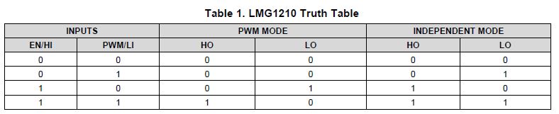

The LMG1210 should be used in PWM-Mode.
The datasheet contains the following Truth Table:

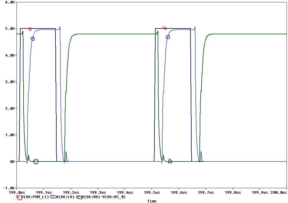

The simulation provides the following graphs, when EN is connected to 5VDC:
The marked points show that the PWM is 1 and the LO is also 1 while HI is 0.

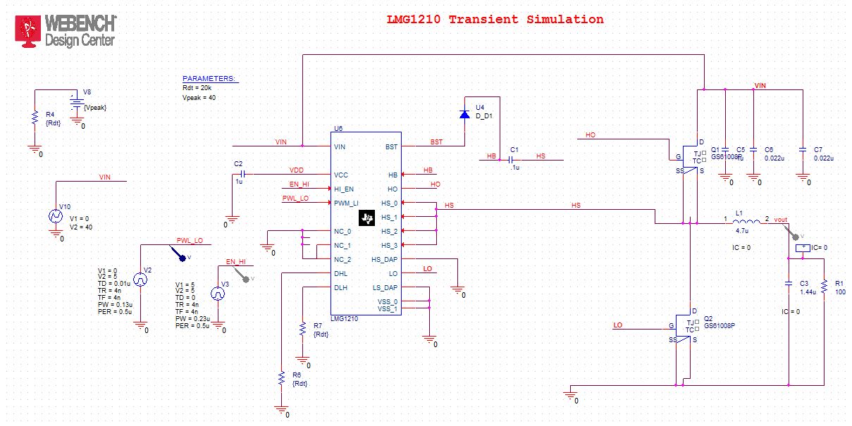

The simulation was also tested with the given project:
