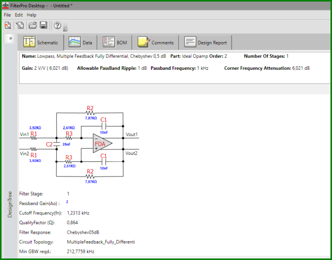

Hi, :-)
I need a symetrical input low pass filter and i used FilterPro Desktop for this.
But what is a FDA opamp?
Thanks for the answer!
Kind regards,
Bram

Bram,
FDA stands for Fully Differential Amplifier. You can find the FDA information at
To find a FDA that has bandwidth greater than 1231Hz, you can use this link.
