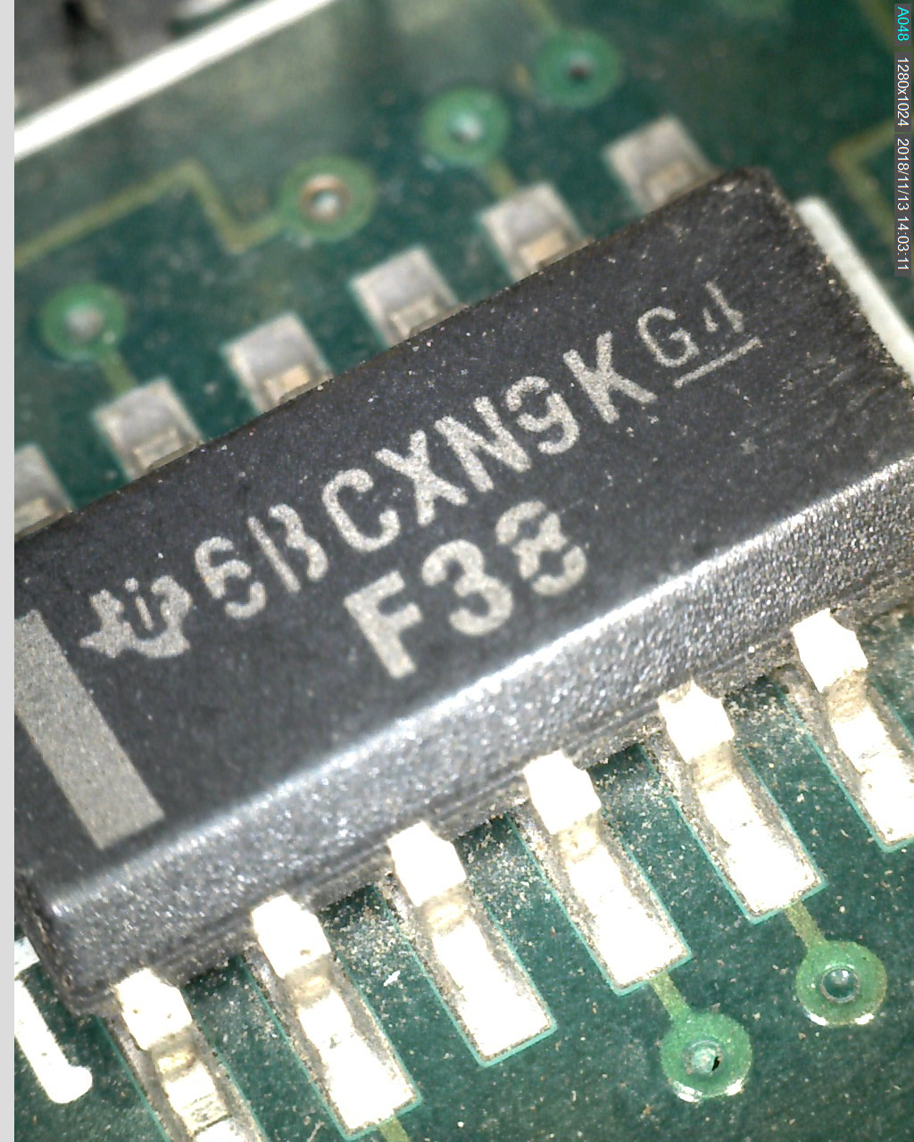

Didn't find the part in web site , Please suggest part number.
Hello Santosh,
Please use the Part Marking Lookup Tool to identify devices: http://www.ti.com/packaging/docs/partlookup.tsp .
In this case, you will see F38 is the SN74F38:
| SN74F38D | F38 | D | 14 | ACTIVE | Quad 2-input positive-NAND buffers with open collector outputs |
