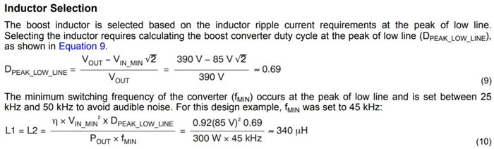

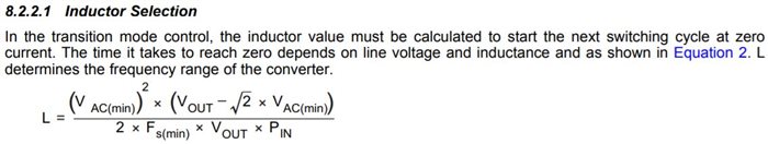

  • Hi Chan,
    Please refer to the inductor calculation in UCC28050 (single phase transition mode controller) datasheet:
    And now compare with inductor claculation in UCC28060 (interleaved transition mode controller) datasheet:
    Comparing these two, we can see that the '2 * Pout' term in the single phase equation has been replaced by 'Pout' in the two phase equation. This accounts for the correction factor for two phase operation. In effect, the power has been reduced by half in the two phase operation equation.
    Hope this clarifies.
    Salil
  • Hi Chan,
    Sorry, I attached the same equation for both.
    For UCC28050, please see the correct equation below:
    Salil
