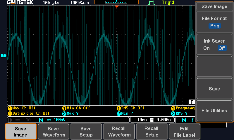

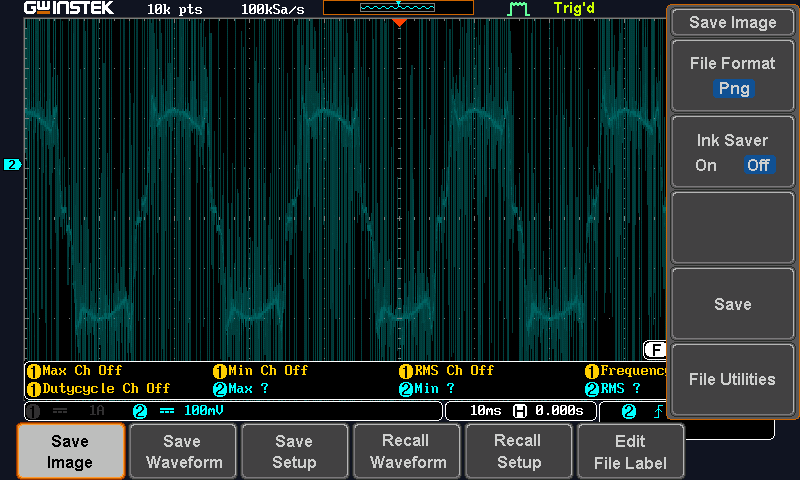

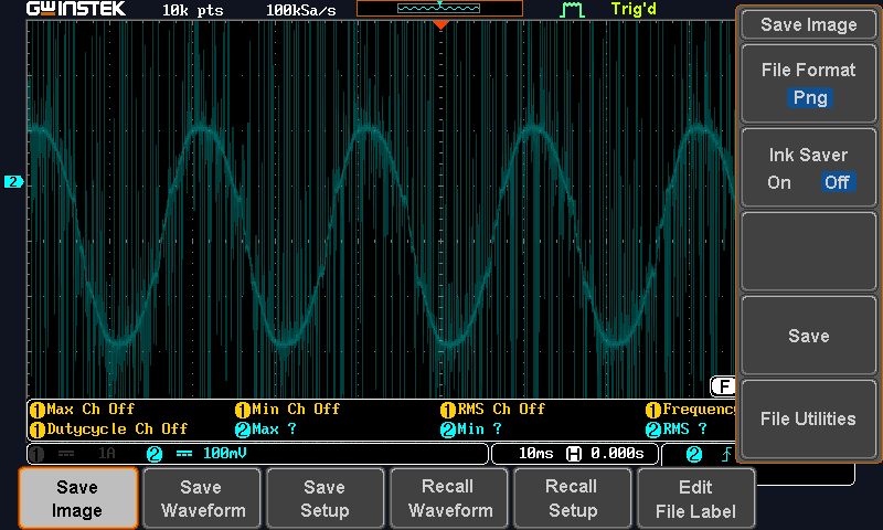

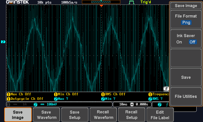

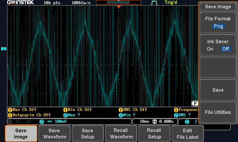

  • Hi Jason, It is found that PFC is catching the output voltage of 390v. But input current waveform seems to be distorted a little while I am changing inductor core size and frequency.
    Current waveforms images for different conditions are given as follows.
    image1: actual design, 45KHz
    image2: actual inductor but frequency 90KHz and load 3KW above this load waveform getting distorted which is in image 3.
    image4: Half the core size 90KHz full 3.6KW
    image5: Half the core size 210KHz full load of 3.6KW
    I am not getting the advantage of increasing the frequency(current is getting distorted while decreasing core size by increasing frequency). So it this means that 45KHz and actual suggested inductor core size is the optimum and proper value for this design?
  • Hi Nidheesh,
    Of course, the design is be optimized for PFC choke with the frequency, if you want to increase the working frequency, you have to recalculate the choke, otherwise it could not work normal.
    BR
    Jason
