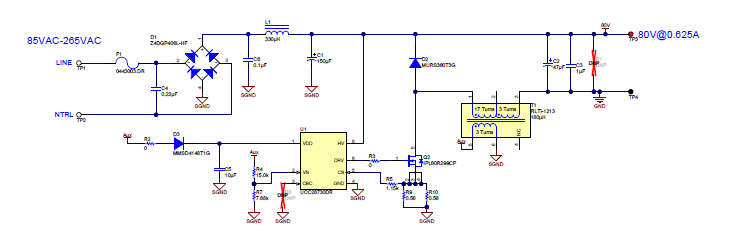

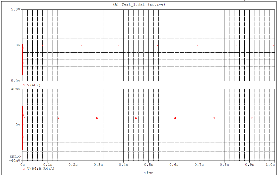

I am trying to simulate the PMP20686 with little modification.
While simulating the IC, we are facing the issue regarding the auxiliary output generation.
Here, the transformer model is same as provided in the Webench UCC28730 transient simulation.
The schematic of the simulation is attached herewith.
Please provide un-encrypted SPICE model for simulation purpose only.
-Rushi

  • Herman,
    The simulation results and schematic are attached herewith.
    I want to simulate the same circuit is LTSPICE and for that unencrypted SPICE model is required.
    -Rushi

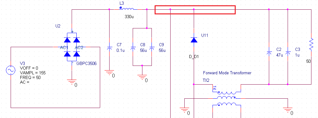

  • Hi Rushi,
    Sorry for the delay in response. I tried to analyse the circuit designed by you and have the following queries.
    1. I observed the input and output stages are connected together. Could you please explain the reason behind this?
    2. Is the transformer placed properly in your design? Is the AUX voltage generation proper? If yes, What is the expected voltage at AUX node for your design? (Kindly refer the released schematic if you have doubt on how to generate AUX voltage)
    Thanks & Regards,
    Arpan Gupta
  • Hi Arpan,
    For the queries:
    1. In the up-side down buck converter, the switch is placed in return path. Please refer the schematic of PMP20686 reference design.
    2. The transformer is placed properly (Refer PMP20686). In the simulation, AUX voltage is not generated at all (shared results). The expected voltage at AUX is 12 V.
    Please find the attached schematic of PMP20686 80V power supply.
    Thanks and Regards,
    Rushi
