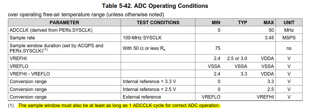

Q1:I see TIDA-00961 use low bandwidth(DC~120kHz) current sensor ACS716KLATR-12CB-NL-T , does it have serious attenuation at high switching frequencies?
If so, how do you overcome this problem?
And different delay times in the variable frequency condition, how to overcome?
Q2: Dose TMSF280049 ADCCLK is up to 50MHz? Because I set the ADCCLK = 100MHz, but didn't see any problem, so I want to confirm that this value is correct from datasheet?.
Thanks for your help!!
