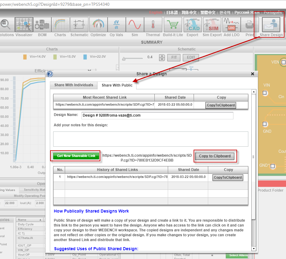

    If you can please share your design URL using the screenshot below as reference, then we can find out more on this. I am assuming since it is an old design, that is comes from Flash version of the tool.
    If it is in the HTML version of the tool, please see screenshot below for reference:

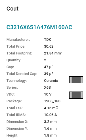

    (d) Your shared design demonstrates what appears to be a bug in how the HTML tool reports the values for parallel capacitors such as this choice for Cout, which is two off 47µF 10V X6S ceramic (derated to 39µF total) each with ESR of 2.082mΩ:
    However, clicking on this part and selecting "Show more details" reports a total ESR of twice this value, rather than half:
    The "Alternate part selection" dialogue does show the total ESR correctly as 1.0mΩ:

    2.d. Thanks a lot for pointing this issue out. It is indeed a bug. We will work on the fix for this in the upcoming release. Will let you know details on when to expect the fix.
