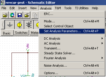

Tool/software: TINA-TI or Spice Models
My simulation stops after 25% completion. It says, "Convergence problem. Check the analysis parameters! "
Please guide me to solve this issue. Thanks.

Hi Sunil,
Please follow the below steps to solve simulation non convergence issue.
1. Go to Analysis-->Set Analysis parameters.
2. Analysis parameter window (shown below) will open. Please try to increase the value of highlighted analysis parameters to get rid of non convergence issue.
