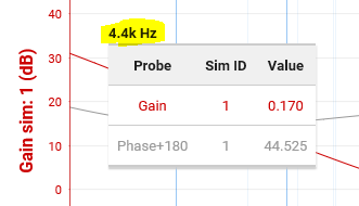

(a) The displayed resolution in frequency is much coarser (2 significant digits), and does not improve if you zoom in the frequency axis, although the resolution in gain and phase is still more than adequate (3 decimal places).
(b) If you zoom in the frequency axis to allow finer control of the Marker, you can find different values of frequency (even with its coarse resolution) that report identical values of gain and phase (even with their fine resolution), which looks like a bug:
