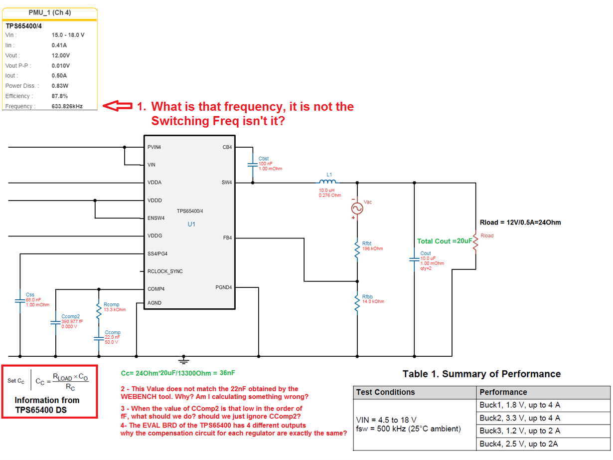

Please check the questions written in the image attached in regards to the calculation of the compensation circuit components.
  • Luis,
    1. Yes, it is the channel switching frequency.
    2. Cout value of 20uF is without the DC bias derating. If you check the derated value, it would probably be lower than 20uF which can lead to lower value on Ccomp or Cc.
    3. Yes, really low values of Ccomp2 suggest you may not need it on the board though it is a good idea to check the actual measurements and ensure you have sufficient gain margin at higher frequencies so it rejects noise.
    4. I see the power stage inductor and output capacitor are identical for all channels which is usually a big factor in how the compensation design works but not sure why all components are identical.
    In addition to what I have said above, for questions 3 and 4, I am requesting a product expert to take a look and provide feedback.
    Amod
  • Hi Luis,
    Let me answer your Q3~4.
    Q3: The equation you get from datasheet is also an approximate calculation. What's behind the Webench is some mathematical equations and also bench validation results.  I would suggest you to follow the Webench result. As the fF order result, you can just leave it open. Sometimes Webench does give out values which looks unreasonable. This is because the webench model always give out a non-zero vaule for each component on the schematic.
    Q4: Compensation doesn't need to be very very accurate. The same compensation network can keep the loop stable for the default configurations on the EVM. However, as you required, Vout is much higher than the EVM (I remember it was 12V). This will need a re-design for the compensation.
    Hao

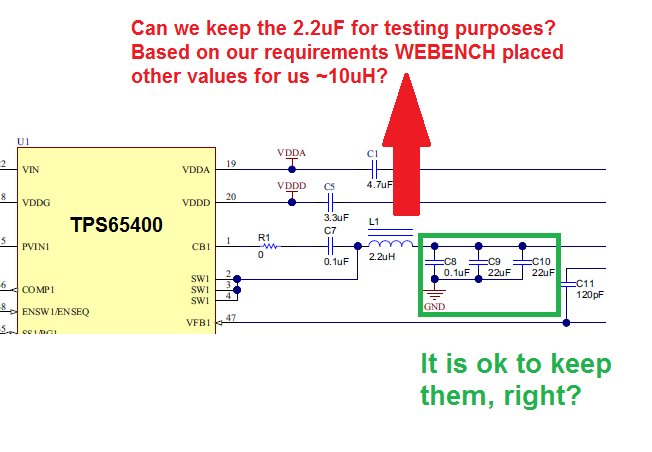

    D. For 1~3.3V, even 5V, you may keep the 2.2uH. For higher Vout, you do need higher indutance.
