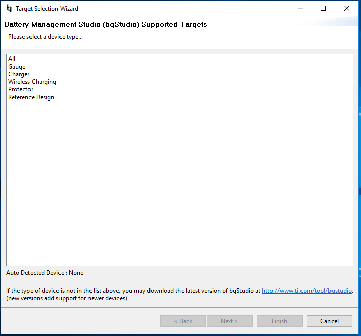

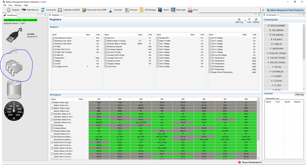

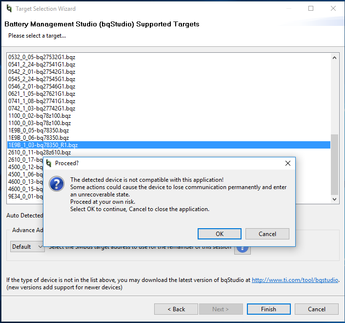

I have made my own board using the reference design (TIDA-00792). I have connected the battery and cells, and on boot up I successfully see BQ76920's REGOUT go to 2.5V and CAP1 go to 3.3V. This REGOUT feeds into the VCC pin of BQ78350-R1. But when I connect the gauge to the BQstudio using the SMBus and EV2400, the gauge would not show as connected. Can you plz guide what's wrong?
p.s. I have attached three pictures that show the BQstudio would not automatically detect neither would it connect once after I manually select the gauge.

    It looks like something is preventing communication between the EV2400 and the BQ78350-R1 device. Here are a few things to check:
    - I see there are no pull-up resistors for the BQ78350-R1 SDA and SCL lines.
    - Measure the voltage on the REGOUT pin of the BQ76940 (this supplies VCC for the BQ78350-R1). It should be showing 3.3V. If it is not showing a voltage, the device is in SHIP mode and needs a rising voltage on the TS1 pin to come out of wake-up. If you have a button (S1), this can be accomplished by pushing this button.

  • I'm sorry, you are correct about the BQ78350-R1 VCC voltage. 2.5V is the correct value, so the device you are using (BQ7694000) should not be an issue.
    I am not sure why the communication with the device would not be working in that case. You should be connecting to the SMBus port (Port 1) on the EV2400 and should be able to observe waveforms on the SCL / SDA pins. When you open BQStudio, maybe you can try to click on the button near the bottom to select the SMBus address or scan for the address - this is just in case BQStudio is not seeing the address it expects.
