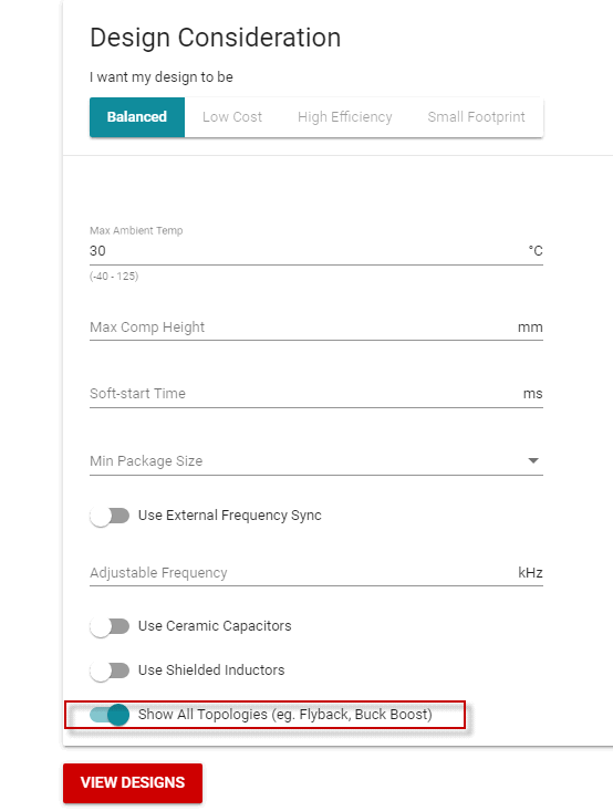

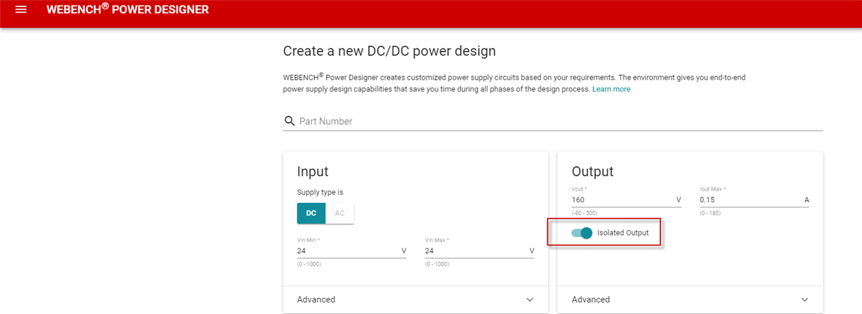

I must design an isolated switching step up from 24V to 160V -150mA...what do you suggest ?
Hi Mario,
You can try the WEBENCH power designer at http://webench.ti.com/power-designer with these inputs to see if you find anything interesting to you. Please see screenshot settings below to get isolated output designs. Please let me know if there are any other questions.
