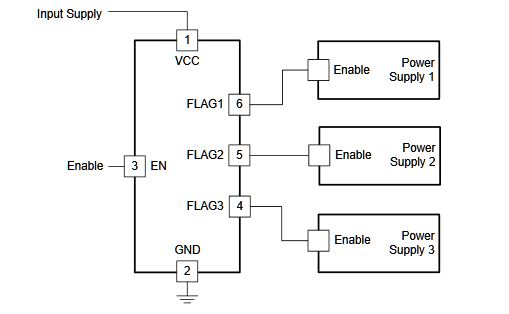

I'm struggling a little bit here with the LM3880DBV circuit usage in  a multi rail power supply that I generated in the Webench tool.
So, here is my power supply circuit:
And this is how I sequenced my circuit:
My problem is I don't know where to put the sequencer circuit in my main schematic, before or after the outputs? As in the above schematic, it looks like the sequencer has to be connected to the end of the last output which is so confusing!!!! While in the LM3880DBV datasheet it seems to be placed before the generated outputs, as shown here:
I'm so confused here! Please, any help!?
