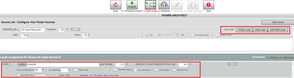

Hello
I want to try out the multiple output smps design in webench power design, but there is no option for add the output .
can ou help me with this.
looking forward to this query.

Hi Sourabh,
You can go to WEBENCH power architect at: https://webench.ti.com/webench5/power/webench5.cgi?app=power_architect and click on the "Add Load" option to add details about the output. Please check screenshot below for reference.
