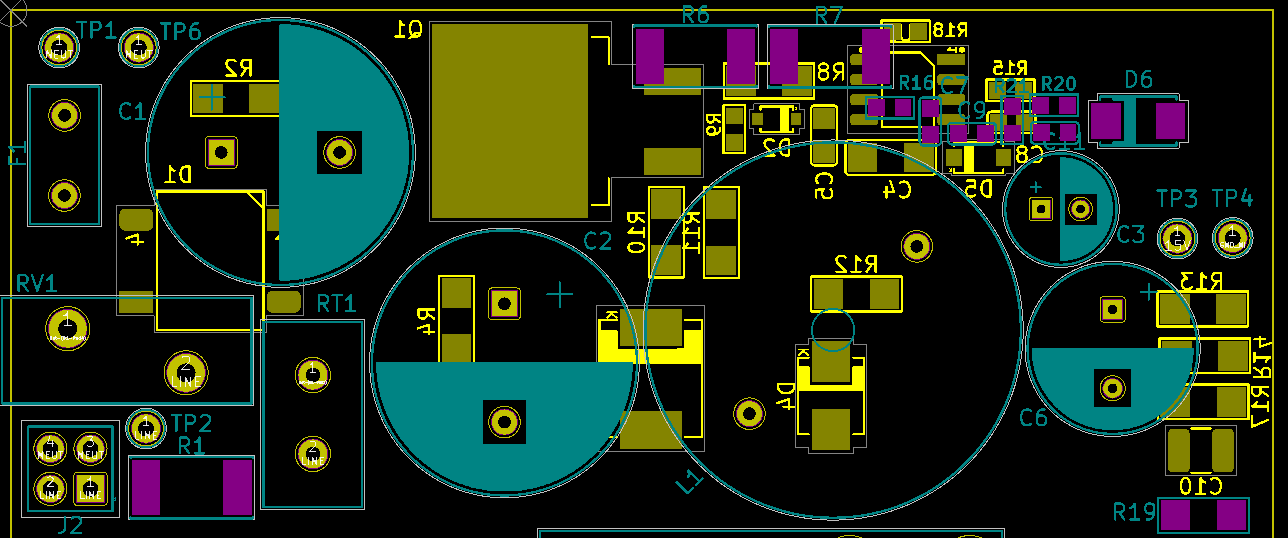

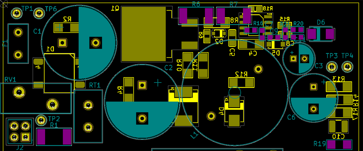

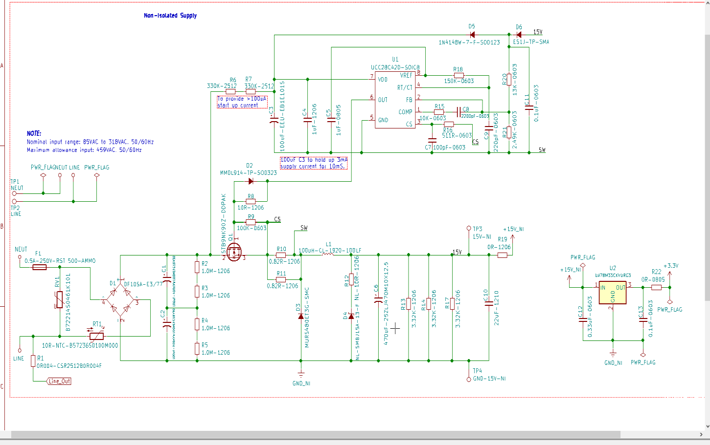

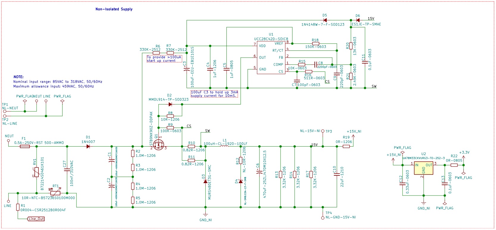

I have designed smps of 15V/1A with reference design of PMP10833
I have attached schematic and pcb layout(Placement of components) for review purpose.
Pls review below layout(Placement of components) and give any changes or suggestion for better performance of smps.
