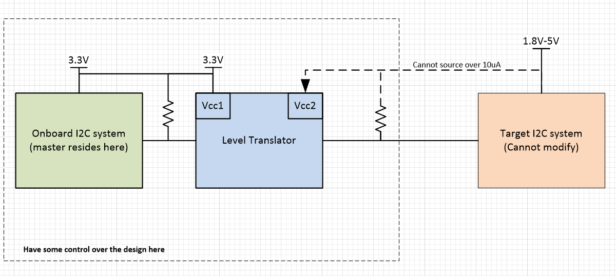

We are looking to design a level shifter for an I2C bus between our system and a target device. The
specifications for each are as follows:
System:
 3.3V I2C bus (2 data lines – SDA and SCL)
 3.3V power supply capable of sourcing 1A
 5.0V power supply capable of sourcing 1A
Target:
 Unknown voltage I2C bus between 1.8V – 5.0V
 Target voltage reference capable of sourcing 10uA
 Common ground with the host system
Please do provide a solution.
