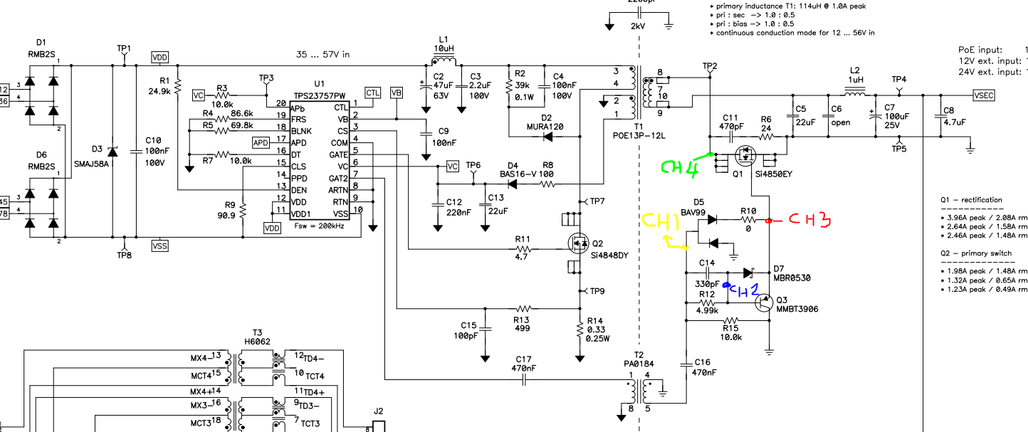

Hi E2E,
Our customer refer PMP4745  to design TPS23757.
But the MOS which customer use that had higher Qg lead to VGS can't pull low at the moment. (Please refer the waveform)
(Customer MOS's Qg=42nC, PMP4745 MOS's Qg=17nC)
We modify R12 to 43.2R  can fix this issue. (the Q1 Gate can pull low fast)
Could you let us know does have any risk with modify R12 to 43.2R?
Thanks!
Circuit:
Waveform:
  • Hi Julian,
    If you reduce base resistor down to 43.2 ohms then the BJT will need be higher rated. Probably the lowest you should go is half the 5k resistor with that BJT. The tradeoff is efficiency. I've seen designs that add a resistor across the gate to ground as well to speed up the shutoff.
