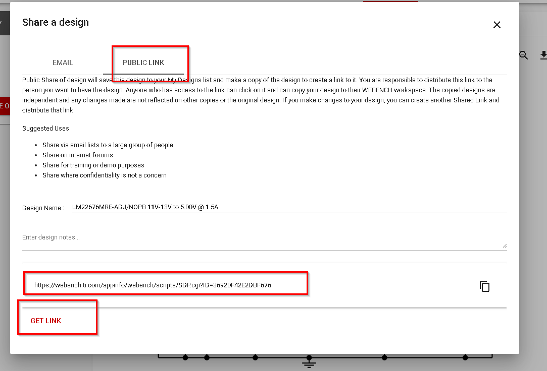

Did you get the shared design?
/cfs-file/__key/communityserver-discussions-components-files/234/WBDesign26_5F00_CadSoftEAGLE.zip
This file is the exported design in Eagle PCB format
Phil

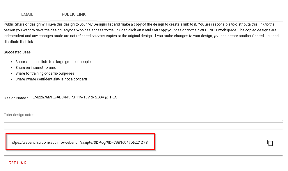

https://webench.ti.com/appinfo/webench/scripts/SDP.cgi?ID=8DFDD8264CA67D0C
As requested link to design.

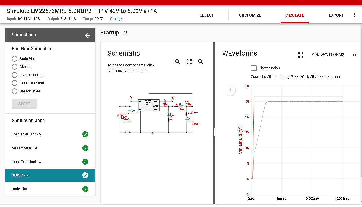

Hi Phil,
Thanks for sharing the design. Please note that I am able to view the circuit after simulations.
Regarding PCB, this board is designed for multiple components and this works for LM2267X-5.0 as well.
For 5V operation do not place Css, Rfb1 and use zero ohm resistor for Rfb2.
