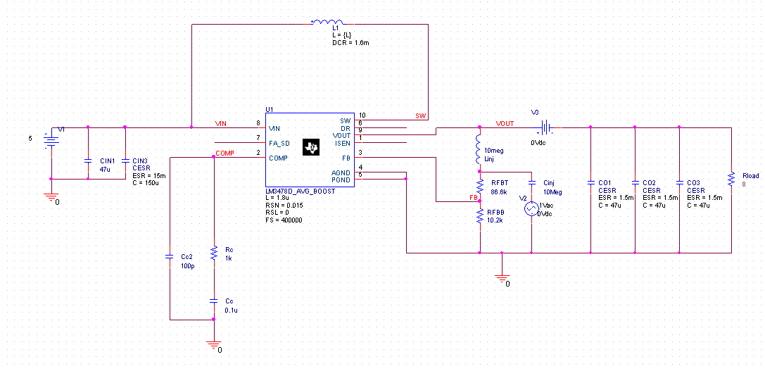

    The TINA reference design is not available for Boost average model configuration. You can create that design in TINA as unencrypted average model is available on website. It contains both boost and sepic average model.
    LM3478 Unencrypted PSpice Average Model
    You can create MACRO of LM3478 boost average model in TINA-TI from unencrypted Lib file & configure test bench similar to released Pspice model (as shown below).
    Please let me know if you have any questions.
