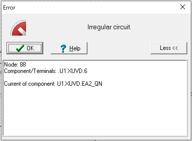

Can you plz help me out for the error.
In the below figure, simulation is not proceeding and giving error.

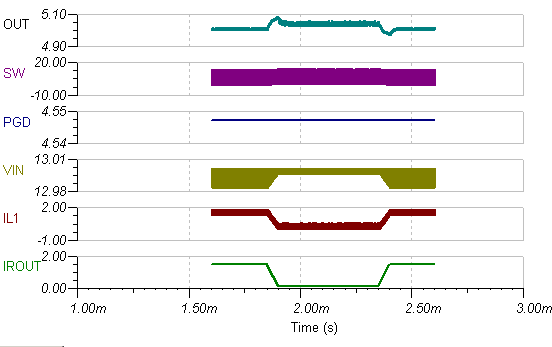

I have configured your test setup and found that it runs properly. snvm519.tsc.
Below is the simulation result.
Can you please check if you are using the latest version of TINA-TI (9.3.200.277 SF-TI).
