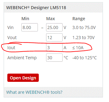

Why is there a range for the output current limit for the LM5118 (<= 10A)?

As discussed over mail. The Output load is limited to 10A in WEBENCH mainly because of thermal concern. Kindly let us know if there is any query.
