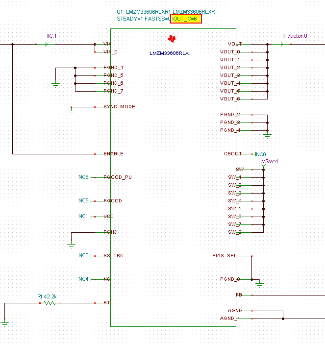

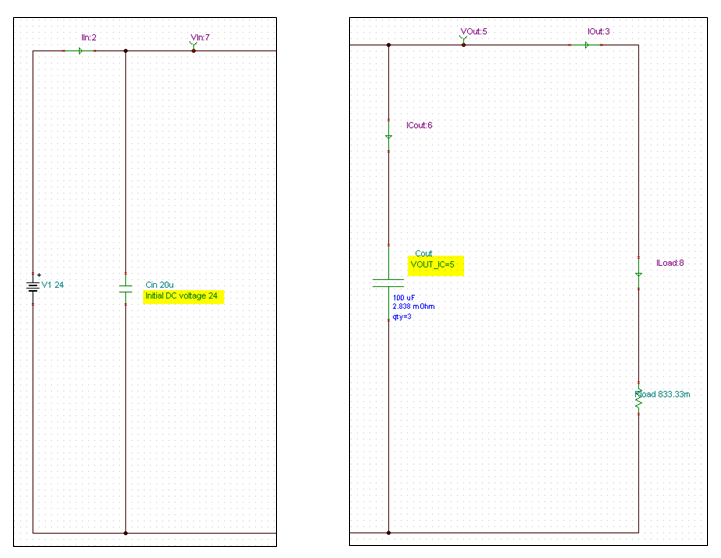

    If you are interested to view steady-state values/results of various node voltages/branch current, you can add voltage/current probes & run transient analysis (Ctrl+Alt+T to run transient analysis) to attached TINA-TI test-bench.
    Kindly note that the test-bench has been modified to directly view steady-state results by skipping initial start-up behavior.
    /cfs-file/__key/communityserver-discussions-components-files/234/LMZM33606_5F00_steady_2D00_state.TSC
    Below are the points to note:
    1. Add appropriate Vin, Vout and Iout parameter values based on your input/output conditions as highlighted in below snapshots.

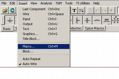

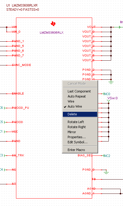

    Please follow below steps to replace the Macro in TINA-TI.
    a. Delete the existing  macro/IC from the exported design. Right click on IC symbol & click on delete as shown below.
    b. To add new Macro, go to Insert -> Macro and insert the macro/symbol in the test-bench.

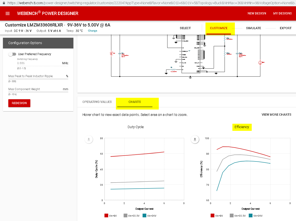

    1. How do I analysis Input and output  wattage?(I want to know efficiency.)
    Harish - In general, efficiency can be calculated as (Vout*Iout) / (Vin*Iin) where Iin is the input current that flows into IC through Vin pin.
    But the SPICE models (Electrical models) supported may not provide accurate loss analysis as the power dissipation parameters like quiescent current, MOSFET switching losses etc are not accurately modeled.
    You can instead use WEBENCH charts to get the efficiency at different loads, Vin voltage as shown in below snapshot.
