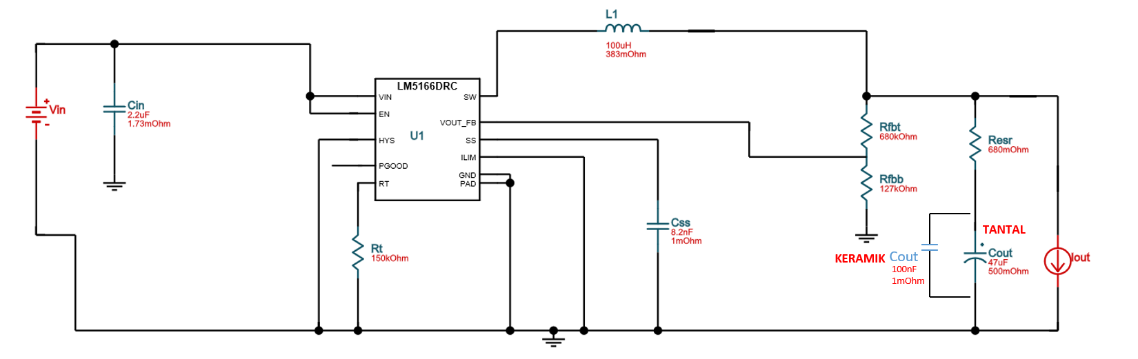

Vin = 36 V und Vout = 7.8 V; Maximum load current at 7.8 A = 0.3 A, Fsw = 300 kHz
Is this a correct design of my circuit for the  parameters? Is it possible to combine tantalum capacitors and ceramic capacitors at Cout ? (see in the picture) Tantalum capacitors have a higher ESR compared to ceramic capacitors (here: 500 mOhm at TANTAL). Is this still realizable?
Do you have any suggestions for improvement? The design should be as compact as possible and not too large (height max. 4.5 mm).
