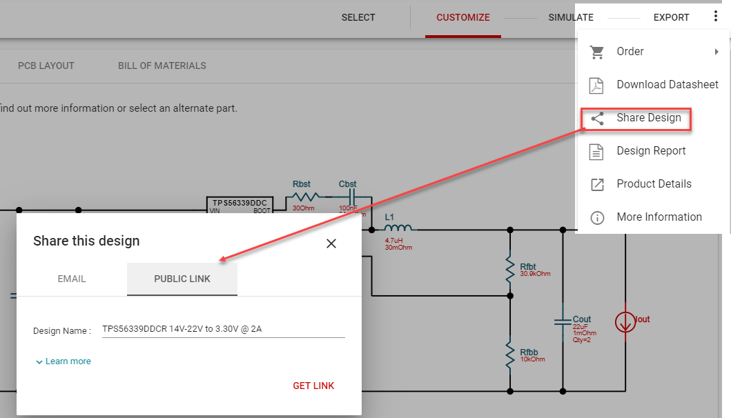

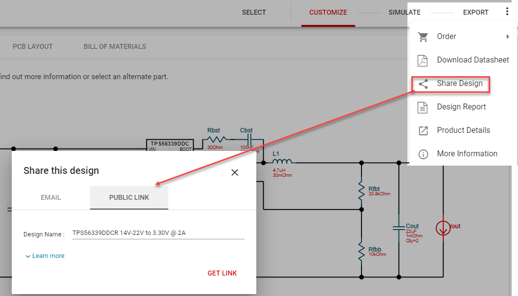

  • Hi Georg,
    Can you please share your design with us? The frequency could be limited due to various reasons related to minimum on and off times, thermal considerations, etc.
