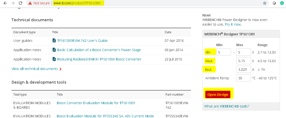

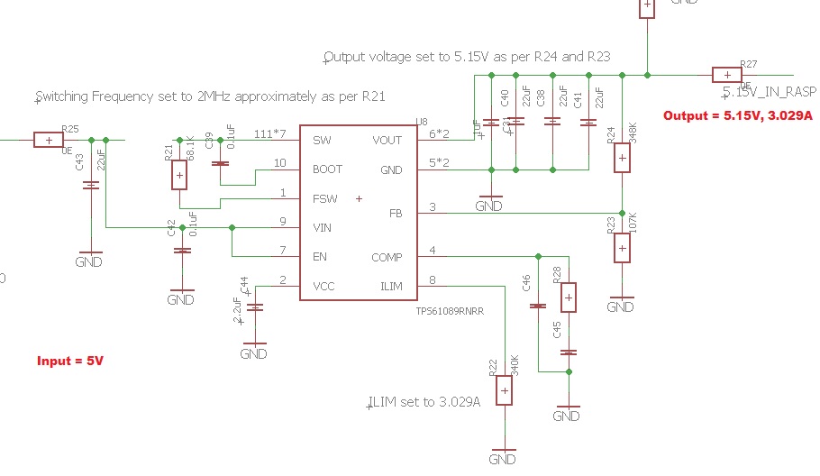

I want to determine the value of  R28, C46, C45 and inductor to be used between VIN and SW pins. Can someone give me values to be substituted in equation 11 of datasheet or let me know how to proceed further. Also it would be kind if someone can cross check if my other values are correct or wrong.
Thanks in Advance.
