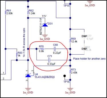

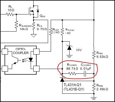

- In the datasheet of PWM controller UCC28C43-Q1 transfer function arrived in equation (53) doesn’t include the type 2 compensation (see below image) while the reference design TIDA-01505 include type 2-compensation. Can you provide the transfer function to check the stability.

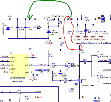

- In the below image, VDD connection to Totem pole is given directly from unregulated voltage from Transformer Auxiliary winding. Is this purposefully done as shown in below figure (red color) . Or it should have been connected to regulated supply as shown in figure(green color).

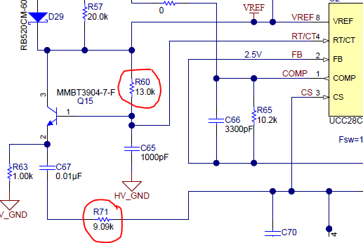

- In the reference design TIDA-01505 under the slope compensation network, Rramp (R71=9.09kohm). But its suggested to choose this resistor value higher than the value used in RT resistor (R60 =13K) as per section 2.3.11.1 (between equation 54 & equation 55). Refer the below image:
