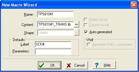

I can not import the PSPICE model provided by TI on TI website to the TINA-TI, I have below message
Can someone advise a correct method to import the PSPICE model?

The PSpice models provided in the Product folders on the TI Website are encrypted and can only be used in PSpice version 15.7 or higher. There is a standard way to request unencrypted models for the models available on the Web.
Please see the following post:
http://e2e.ti.com/support/development_tools/webench_design_center/f/234/t/36943.aspx
I will send you an email with additional information shortly.
