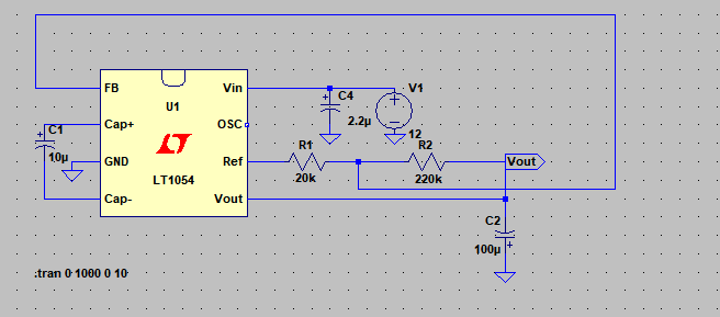

Dear Youhao Xi,

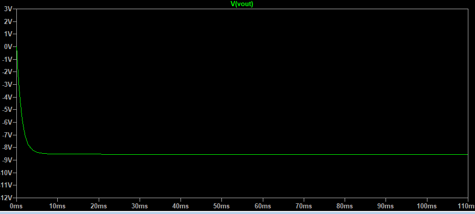

Good Afternoon, My requirement is to generate -9V from +12V DC. I have used LTspice simulation tools and simulated LT1054.
Results what i have achieved is as follows
Condition 1: When FB pin is left open Input 9V is given output voltage is -8.8V V at 100mA load. Where output voltage falls from 0V to -9V at 5mS time period.

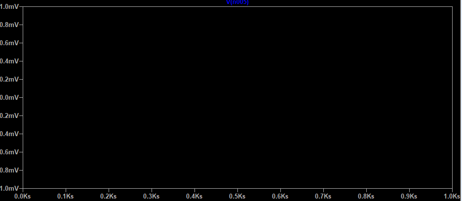

Condition 2: When FB pin is connected with 220K and 20K Input 12V is give output voltage is 0V .
Simulation results:
Can you please let me know why Output voltage is not available when i connect a feedback voltage.
I am not sure if the LT1054 mode is correct. Like I said, this is a simple circuit and it may be faster to get the IC and build the board to do bench eval.
Referring to the datasheet, a 0.002uF capacitor is recommended to be placed in parallel to R2.
