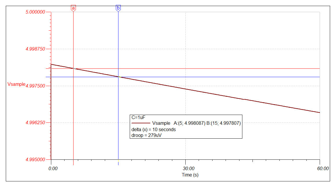

The other day I taught you to use a voltage control switch as a model for the sample hold circuit at TINA-TI.
In this case, what should we do to achieve the droop rate of the sample and hold circuit?

Hi user5994067,
We do not have a model for the LF398. However, if you build a simplified model of the sample-and-hold switch controlled with a voltage source, you may model the droop rate by applying a small DC leakage current source on the sample-and-hold capacitor.
The leakage current into the hold capacitor is 30pA typ and 200pA max. Applying in TINA a 30pA DC current source to drain the capacitor would be a rough model of the the droop rate of the sample-an-hold. Below is a rough model using a 30pA leakage current.
