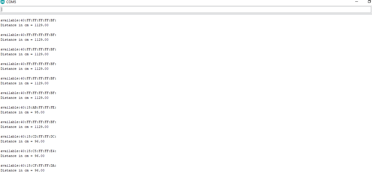

    Thanks for response, i tried what you suggested results are as below.
    >>I changed preset 1 and 2 current limits to 300mA  and result of ultrasonic measurement(0x05) am getting 0xFFFF continuously , there is a change on object detection as values changes to some random values from 0xFFFF, but the values received are not giving accurate distance.
    >> I also checked with echo data dump, a continuous 0xFF's will change on object detection.
    >>I also checked the THR_CRC_ERR value after configurations, value am getting is '0' so no errors with respect to threshold values update.
    I have attached screenshot of ultrasonic measurement results value, please let me know what else i can try to get proper values.
  • Hi Chetan,
    You occasionally see a value at approximately 0x15CD, which is about 95cm in distance, so the threshold detection is working, but the echo data dump output could help confirm if the 95cm object is real or a false positive from the short to long digital gain adjustment.

    Thanks for your response and support on this.
    I have solved the issue , sensor is detecting objects after 40cm range, initially i have made a setup of square box of 40x40cm and hence i was not able to get any object detection.
    Now i am able to detect the object after 40cm.
    Actually our application needs very short range detection like 2cm - 100cm with "mm" accuracy.
