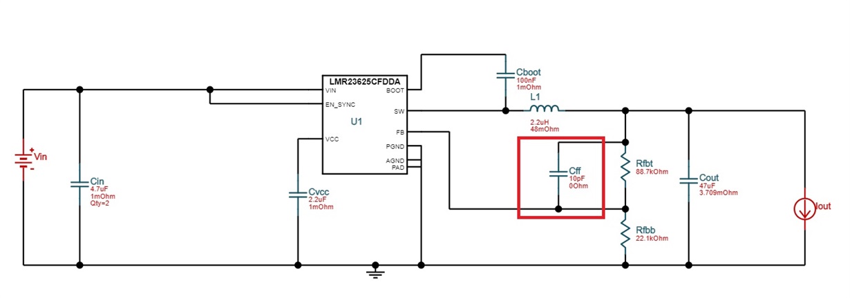

I have question for Cff value of LMR23625 based power supply.
In WEBENCH, I designed power supply in the condition as below;
Input : DC8V-31.5V
Output 5V, 2.1A
At this condition, Cff is suggested 10pF.
But if I followed datasheet calculation (formula 17 and 18), the value will be 25pF.
There is difference between two suggestion.
Which value should I follow better?
