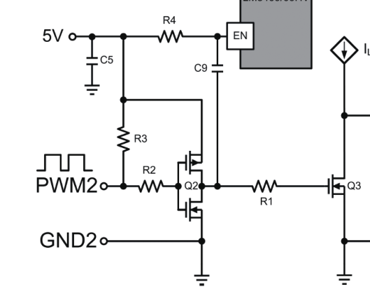

hello,this is a sch from Figure 4. External shunt FET dimming circuit with EN pin coupling of AN-1953 LM3409HV Evaluation Board .I found the EN level is same as R1. EN low levels means system should shutdown.I have two questions.
1:C9 is not used for Bootstrap circuit?
2:How to understand FET dimming working with system shutdown?
C9 causes EN to go low for a short time when the Shunt FET opens. EN should not be low, R4 is 100 ohms and C9 is 2200 pF. This is a time constant of 220 ns. EN should not be the same level as R1.
1) yes, it causes a short low state when the shunt FET is opened.
2) The LM3409 should be enabled when the shunt FET is shorting the LED stack.

hello,the blue wave is the R1,the yellow wave is the EN. I used two kinds of PWM.but I also found the EN test point is same as R1. I know LED "External shunt FET dimming" system not dimmer by EN. but last I also undersand why need introduction C9 for 220ns?why the EN need experience low voltage in "External shunt FET dimming circui" system.
I found the system will be more stable in very little PWM Duty cycle with C9(eg. 0.06%Duty cycle 20KHZ). if without C9,the LED will always flashwhy with little PWM Duty cycle 。why the C9 is so important and specific role in the system?
C9 restarts the PWM cycle. This is not the preferred method to use when shunt FET dimming. A second Roff resistor to supply current to the Coff pin is:
See 8.3.8 and Figure 27 in the datasheet.

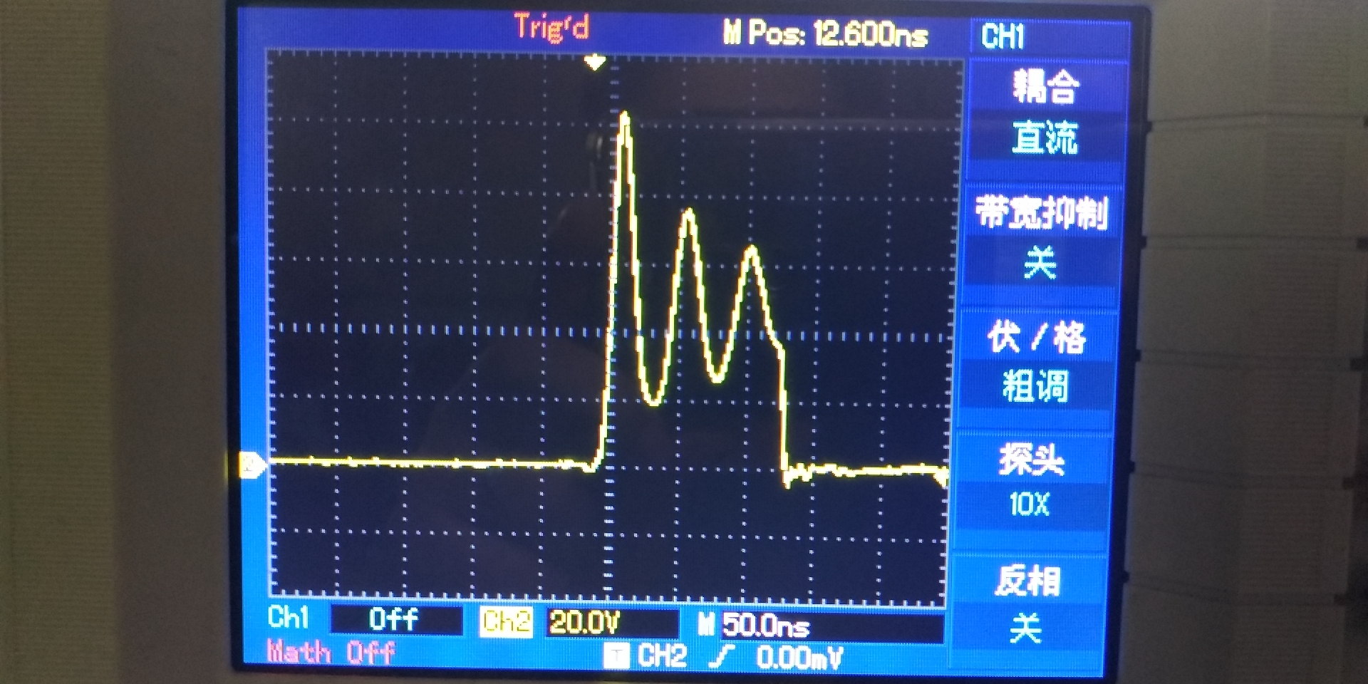

I'm not sure what you are asking. What are you trying to do? There is a lot of high frequency ringing. Are you using the EVM or your own board?
What are the voltage ratings of your Shunt MOSFET? Your scope is showing around 100V on the output peak during the ringing.

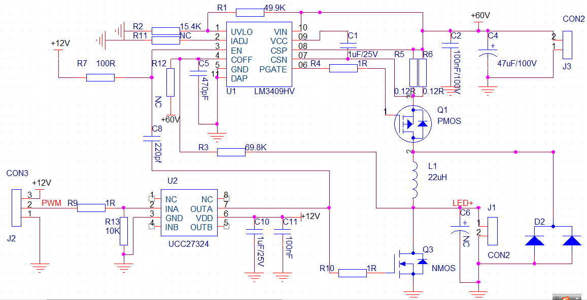

hello,I used my board,this is my sch,the N mos is 150V voltage ratings.
I want to make the beads light by very low duty ratio(eg.J2 with 13ns Pulse width).
1:I test found C8 can make system more stable by low duty ratio,I want to understand the principle.
“C8 restarts the PWM cycle. ” Can I understand for this:PMOS working frequency need synchronous with N mos dimmer frequency? but look like tps92641 ,it not used c8 with External Parallel FET Dimming?
2:what can I do to reduce a lot of high frequency ringing.
thanks very much.
1) The circuit comprising of C8 in your design was an earlier attempt to recover from when the Shunt FET was closed and Vout went low. All it is doing is resetting the LM3409 to turn on the switching MOSFET when the EN pulse goes back high. The correct, or better, fix is the second Roff resistor that keeps the off-timer running when the output is low. This is mentioned before per Figure 27 and section 8.3.8 in the datasheet. If your MOSFETs failed it was not implemented correct. The TPS92641 part was developed later and works different.
2) How are the LEDs connected to the LM3409 circuit? Are there wires? Ringing is caused by parasitic inductance. How are you measuring these signals? The oscilloscope connections cannot have much inductance either. Have you looked at the drive waveform to see if the measurement is correct?

1) Hysteretic controller can dim to high ratios. The TPS92641 can also dim to high ratios. The configuration of your setup is causing issues. The waveforms need to be corrected before going further.
2) The parasitic inductance is cause by "the LEDs connected is wired with J1". Those wires are causing the ringing you are seeing. If you look at the voltage across the LEDs, not at the board, it will look different. Try connecting the LEDs or a different LED load with minimal inductance between the output of the LM3409 circuit and the LEDs. The Shunt FET should be close to the LED load with minimal trace or wire inductance.

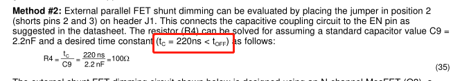

hello ,I look at AN-1953 again today.
1: I want to know if my toff time is set with 242ns,so the tc time need set less than toff time .buy the different tc time whether there are different effects?For example the tc time set 100ns and 200ns .

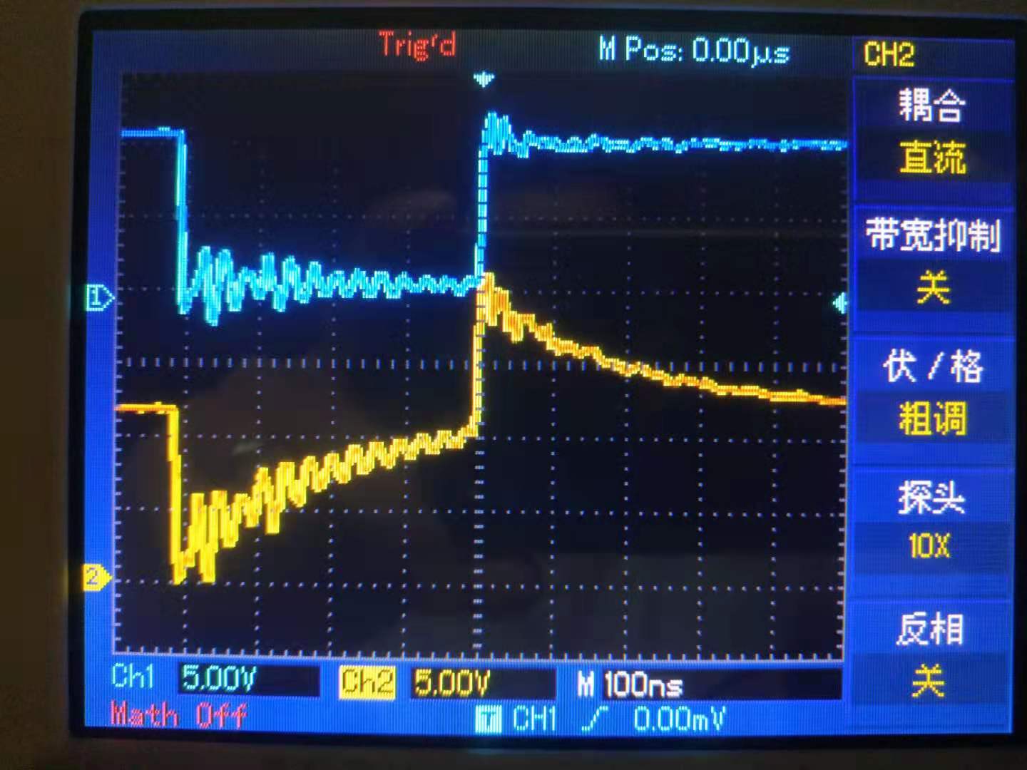

2: I have another question.The yellow is G waveform of NMOS ,the blue is D waveform of NMOS.I found the LED turn on time is slower than turn off time .I want to speed up the LED turn on time,so i try kinds of NMOS to test ,eg. IRF110 .but Not very effective. Is there any reason why the light turns on slowly?

The two Roff resistors is better suited for shunt FET dimming rather than this circuit.
The off-time doesn't have anything to do with the C9 time delay. toff controls how long the switching MOSFET is off during normal operation, with no Shunt FET dimming. The off-time when shunt FET dimming without the second Roff resistor will put it to maximum off-time since Coff cannot charge. When the Shunt FET is on, Vo is zero volts in that equation. Besides you are running from 12V, the off-pulse will be much shorter than a time constant.

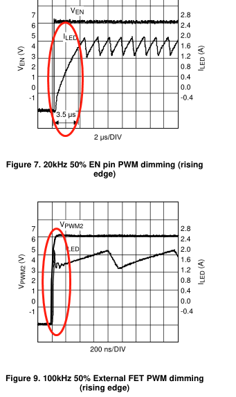

"I have another question.The yellow is G waveform of NMOS ,the blue is D waveform of NMOS.I found the LED turn on time is slower than turn off time .I want to speed up the LED turn on time,so i try kinds of NMOS to test ,eg. IRF110 .but Not very effective. Is there any reason why the light turns on slowly?"
What causes the drain to rise? What causes the drain to fall? When the shunt MOSFET turns on it can pull a lot of current through the drain path. When the shunt FET turns off the inductor current is what pulls the drain high, it is not being forced by the Shunt MOSFET. To speed it up would require less parasitic capacitance across the shunt FET and output. A MOSFET with less Coss will speed it up provided it is a substantial portion of the parasitic capacitance. The equation will be I = C * (dv/dt). I is the inductor current, C is the parasitic capacitance, dv is the output voltage, dt is the slew time. This will be non-linear since Coss varies with Vds.
That delay is the turn on after being off for an extended period so the inductor discharges. The rise time is the time it takes to recharge the inductor. If it is disabled for a very short time the inductor current does not discharge. Shunt FET dimming works different though if the LM3409 output is shunted for a long time it will also discharge but at a much slower rate since the inductor is discharging across the freewheel diode instead of the freewheel diode plus the LEDs. This is why, sometimes, the second Roff is needed. If the Shunt FET is low long enough the current will decrease resulting in a longer recovery time.
