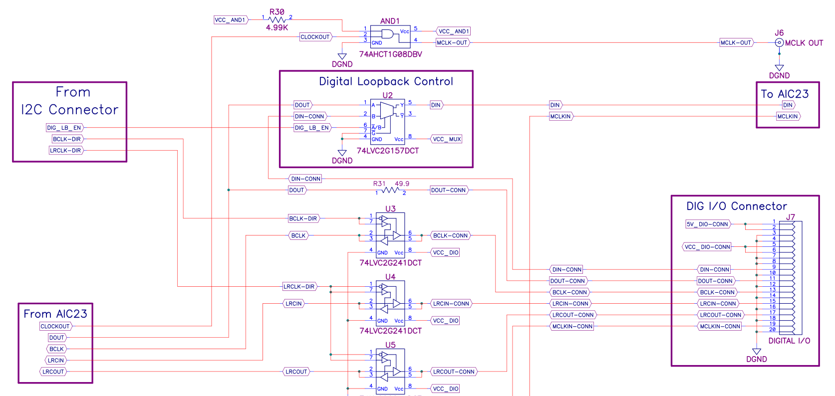

  • Hi Steve,
    Thanks for your advice.In slave mode, from line input to line output, it works. I provide the external clock MCLK,BLCK,LRCIN and LRCOUT at digital interface J7 and select the button 'Dig loopback' at software AIC23 GUI 3.0. But i want to know the button'Dig loopback' how to work?thanks!
    best regards.
    Hai
  • Hai,
    I've attached the user guide here,  it looks like there is a mux on the EVM that handles the loopback.  This is a really old EVM, and I don't have a Windows XP machine that runs the GUI anymore,  so my ability to recreate your setup is limited.
    This is the schematic from the users guide.  that shows the Digital loopback and I/O on J7.   The buffers have Direction controls that come from the I2C connector too,  so you should make sure that the DIR pins are getting toggled.
