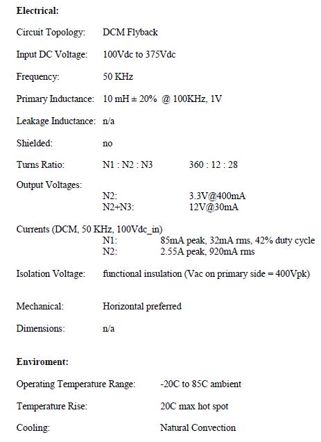

I want to make a similar to PMP22056 , but the problem is I didn't got the custom Transformer design details anywhere, Please provide the details so that I can make My own
Hi Ramesh,
the custom transformer is from Wurth Electronics. You may contact Swaroop for details on the design. We do not have the details of the transformer
Swaroop.Vaidyanath@we-online.com
If you would like just the electrical specifications that we sent to Wurth, we can provide those.
Robert
Thanks for The reply.
Please provide The electrical details that you sent to wurth
Hi Sarmad,
Thanks for The details.
My concern is space for my design. Isolated design would increase my design size, that's The reason I have choose non-isolated.
If possible please provide inductor details which used for 5v,0.55mA design given in this reference design.
Or if you can suggest any inductor value instead of transformer structure it would be useful for me.
If possible please provide those calculation details.
Thank you,
Hi ramesh,
these are the electrical specs used for the transformer. i only changed it to Through hole. i would advise you to use the same TH footprint i used on my non-isolated design PMP22056.
thanks.
