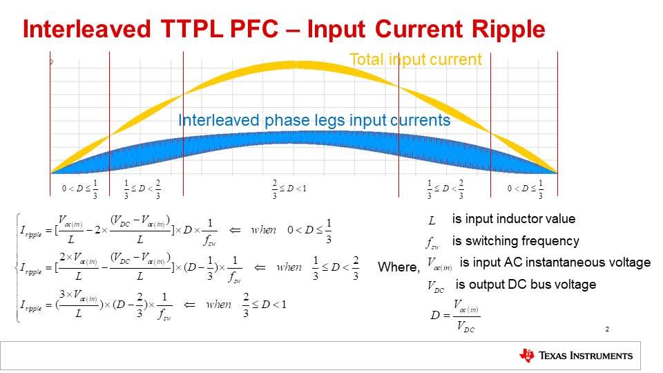

Hello engineer:
        I have some doubts about the design of the inductor.
        Mentioned in the section on inductance parameter design:"As a result, the inductance is calculated as 126 µH at 12 A RMS current.I calculated multiple times using the formula in the design.But never get the results in the design.Could you tell me why?
I am anxiously waiting for your reply.
