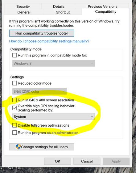

    2. Are you using a 4K monitor? If so, please follow the steps below
    • Right click the USS Design Center link (on desktop) and select "Properties":
    • Select the Pane “Compatibilty”
    • Choose “Override high DPI scaling behavior Scaling performed by”:
    • “System”
    • Apply -> OK
