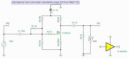

Now, i am planning to run Oscilloscope, signal analyzer, etc. with the attached circuit, but nothing is working with me.
The version I use on TINA-TI is Version 7.0.80.96 SF-TI, Build date: 2009 April 6, 11:48:24 AM and i am not sure how to start the above mentioned measuring techniques.
The circuit is taken form a website: http://gilmore2.chem.northwestern.edu/ubb/showpage.php?fnum=3&tid=7122
Please Help me, Waiting for your response asap.

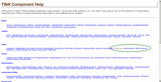

  • Hi Mahir,
    You can find help for these components in the TINA Help Menu. Click on Help --> Component Help as shown below.
    This will bring up the Component Help Window as shown below:
    Help on Oscilloscope, Signal Analyzer can be found under "Meters".
    Let me know if you have any other questions.
    Nikhil Gupta

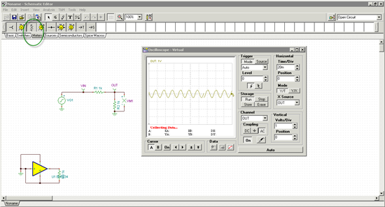

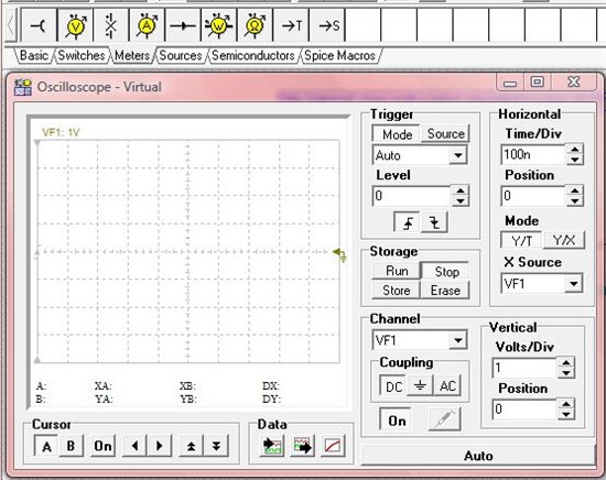

  • Dear Sir,
    Thank you very much for your concern.
    I reached the Help page, but I don't have the same meter par on my prog. I attached an image of  the meter par and the oscilloscope i see which i get it from the T&M menu.
    It is related to the same circuit so when i open it, no signal appears...
    Thanks in Advance...
    Mahir
  • In your schematic, you will need to place the following meter marked by the green circle below. After you do that, place an oscilloscope from the T&M Window, and click on the run button to observe the waveform.
    I hope that answers your question.
    Nikhil Gupta
  • Dear Mr. Nikhil,
    Thank you very much for your great support.... Everything works good right  now!!!

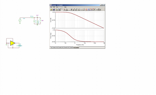

    Finally i can use the Oscilloscope, but what about the bode Plot for the circuit??
    and is this version of TINA-TI have interactive mode???

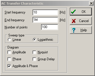

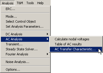

  • Mahir,
    The  best way to run the Bode Plot is as follows:
    1. Add a Voltage Generator  as follows, and set it to a Sine Wave.
    2. From the Analysis Menu, select AC Analysis --> AC Transfer Characteristics
    3. Set the parameters based on how you want to run the Bode Plot.
    4. Click OK and you should see the results

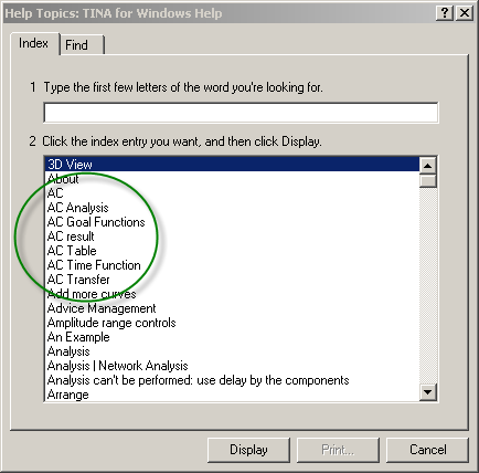

    Details about how to use TINA, place components, use components and run the different analysis are given in the help menu (either through Contents, Topic Search or Component Help). Please search the menu first and if you still have questions, feel free to post it on the forum.

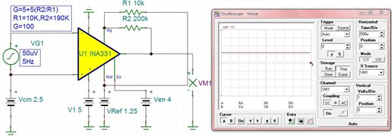

  • Dear Mr. Rick,
    I was thinking about amplifying the signal before switching, so i tried to build a circuit using the amplifier INA331, and i read the data sheet, the circuit is attached and i don't know what is wrong with it!!!
    So i planned to amplify the signal by 100, and according to the datasheet, i chose R1=10KOhm and R2=190KOhm, and connected the resistors R1 between Rg and Ref and R2 between Rg and Vout, I am not sure if these connection are working good as the oscilloscope signal in flat???
    Also, How can I use Ref pin to remove the IN-AMP offset??
    Be sure that i have the honor to deal with such great engineers and great Company.
    Best Regrads.
    Mahir
  • Mahir,
    It may look like a flat line, but it isn't. I built the same circuit in TINA-TI and it works correctly.
    With a 50uV signal (that's 100uV p-p), and a gain of 100, your output signal is only 10mV p-p. If you set the oscilloscope up so that its vertical resolution is 10mV/div, and set the Position to -1.25V, you'll see your signal - it is a 10mV sine wave riding on top of 1.25VDC (the reference voltage). You could also just AC couple it to see the waveform quickly if you don't want to mess with the Position...
    As described in the datasheet, the voltage on the REF pin sets the level the output is referred to (like in your case, the signal begins at 1.25V). You could adjust the REF voltage to compensate for any offset in the input stage.
