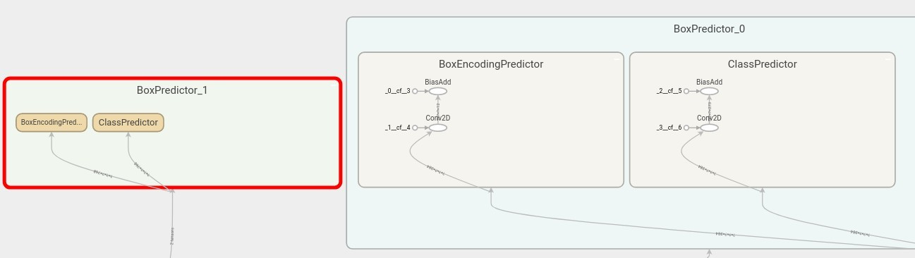

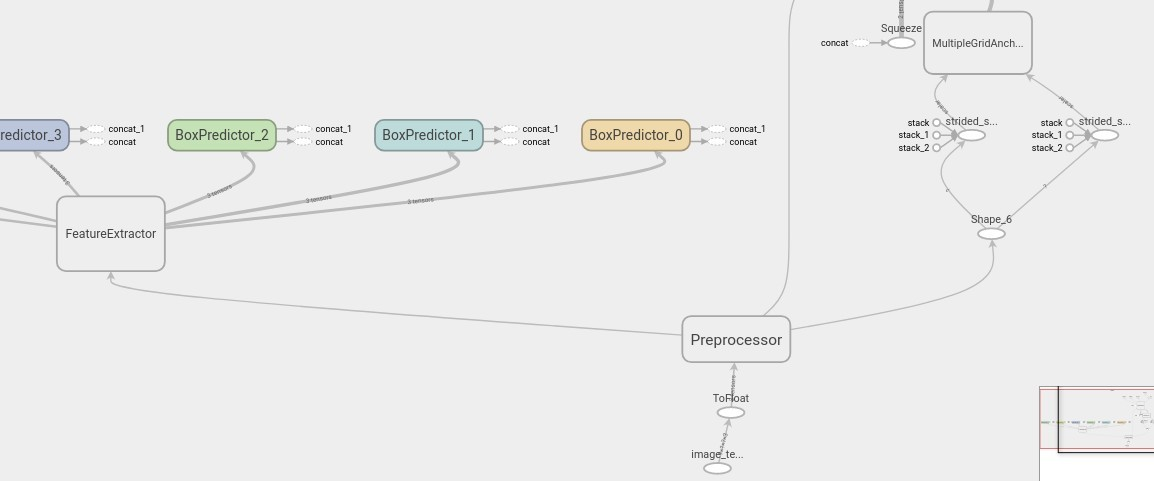

    I am having the same problem with SSD-MobileNetV1, I got the 0.75 version to work, but not the 1.0 version (both with 0.75 and 1.0 pipeline.config file), I get this error (TF operator Const is not suported now..  By passing).
    I also tried an optimized version with optimize_for_inference, but I get the same error.
    I am using the latest SDK on Jacinto 7 (TDA4VM).
    When I visualize both frozen graphs (0.75 and 1.0) on Tensorboard, I see indeed that the 1.0 version uses 6 Const operators that I don't see in the 0.75 version (all the stack nodes at the right of the screenshot bellow)
    Is there a way to bypass this limitation (support of Const layer)?
  • Ideally, the optimize_for_inference script is expected to remove these const operators from the frozen graph.
    Can you specify the only required output names for this script with below argument. After this can you try opening in netron and view this pb file
    --output_names=""BoxPredictor_0/BoxEncodingPredictor/BiasAdd,BoxPredictor_0/ClassPredictor/BiasAdd,BoxPredictor_1/BoxEncodingPredictor/BiasAdd,BoxPredictor_1/ClassPredictor/BiasAdd,BoxPredictor_2/BoxEncodingPredictor/BiasAdd,BoxPredictor_2/ClassPredictor/BiasAdd,BoxPredictor_3/BoxEncodingPredictor/BiasAdd,BoxPredictor_3/ClassPredictor/BiasAdd,BoxPredictor_4/BoxEncodingPredictor/BiasAdd,BoxPredictor_4/ClassPredictor/BiasAdd,BoxPredictor_5/BoxEncodingPredictor/BiasAdd,BoxPredictor_5/ClassPredictor/BiasAdd""
  • I did what you asked, and I don't see Const nodes in Netron or Tensorboard, but I still get the same error, I don't know where do these consts come from.
    This my optimize_for_inference command:
    python -m tensorflow.python.tools.optimize_for_inference \
               --input="/opt/TI/psdk_rtos_auto_j7_06_01_01_12/tidl_j7_01_00_01_00/ti_dl/test/testvecs/models/public/tensorflow/ssd-mobilenetv1_1.0/frozen_inference_graph.pb"  \
               --output="/opt/TI/psdk_rtos_auto_j7_06_01_01_12/tidl_j7_01_00_01_00/ti_dl/test/testvecs/models/public/tensorflow/ssd-mobilenetv1_1.0/frozen_inference_graph_final.pb"  \
               --input_names="Preprocessor/sub" \
               --output_names="BoxPredictor_0/BoxEncodingPredictor/BiasAdd,BoxPredictor_0/ClassPredictor/BiasAdd,BoxPredictor_1/BoxEncodingPredictor/BiasAdd,BoxPredictor_1/ClassPredictor/BiasAdd,BoxPredictor_2/BoxEncodingPredictor/BiasAdd,BoxPredictor_2/ClassPredictor/BiasAdd,BoxPredictor_3/BoxEncodingPredictor/BiasAdd,BoxPredictor_3/ClassPredictor/BiasAdd,BoxPredictor_4/BoxEncodingPredictor/BiasAdd,BoxPredictor_4/ClassPredictor/BiasAdd,BoxPredictor_5/BoxEncodingPredictor/BiasAdd,BoxPredictor_5/ClassPredictor/BiasAdd"
    And I am using Tensorflow 1.12.0 as reported in Tensorflow github mentioned in Note 6.

  • Going back to this issue,
    When I check closely the network after optimize_for_inference I see that there are Const operators in the last blocks (BoxPredictor/BoxEncodingPredictor and BoxPredictor/ClassPredictor) as shown in the screenshot below (_0__cf__3, _1__cf__4, _2__cf__5 and _3__cf__6).
    The problem is that these Const operators are present for both 0.75 and 1.0 optimized networks, though for some reason 0.75 import does not complain about them, while the 1.0 import does.

  • Looks like the model migration step mentioned in the Note 6 of below link is not success full at your set up
    http://software-dl.ti.com/jacinto7/esd/processor-sdk-rtos-jacinto7/latest/exports/docs/tidl_j7_01_00_01_00/ti_dl/docs/user_guide_html/md_tidl_models_info.html
    You are expected to get the fused batch Norm instead of Mul and Add if the model migration is successful. please refer to below.
  • What is interesting is that my setup is able to generate fusedBatchNorm in the case of 0.75 frozen graph, but not for 1.0 version.
    Can you please send me the frozen graph you generated in the screenshot you sent? So I can work around this problem. Thank you.
    __
    Youcef.
  • The frozen graph is shared at the below link. Alex has permission to access this.
