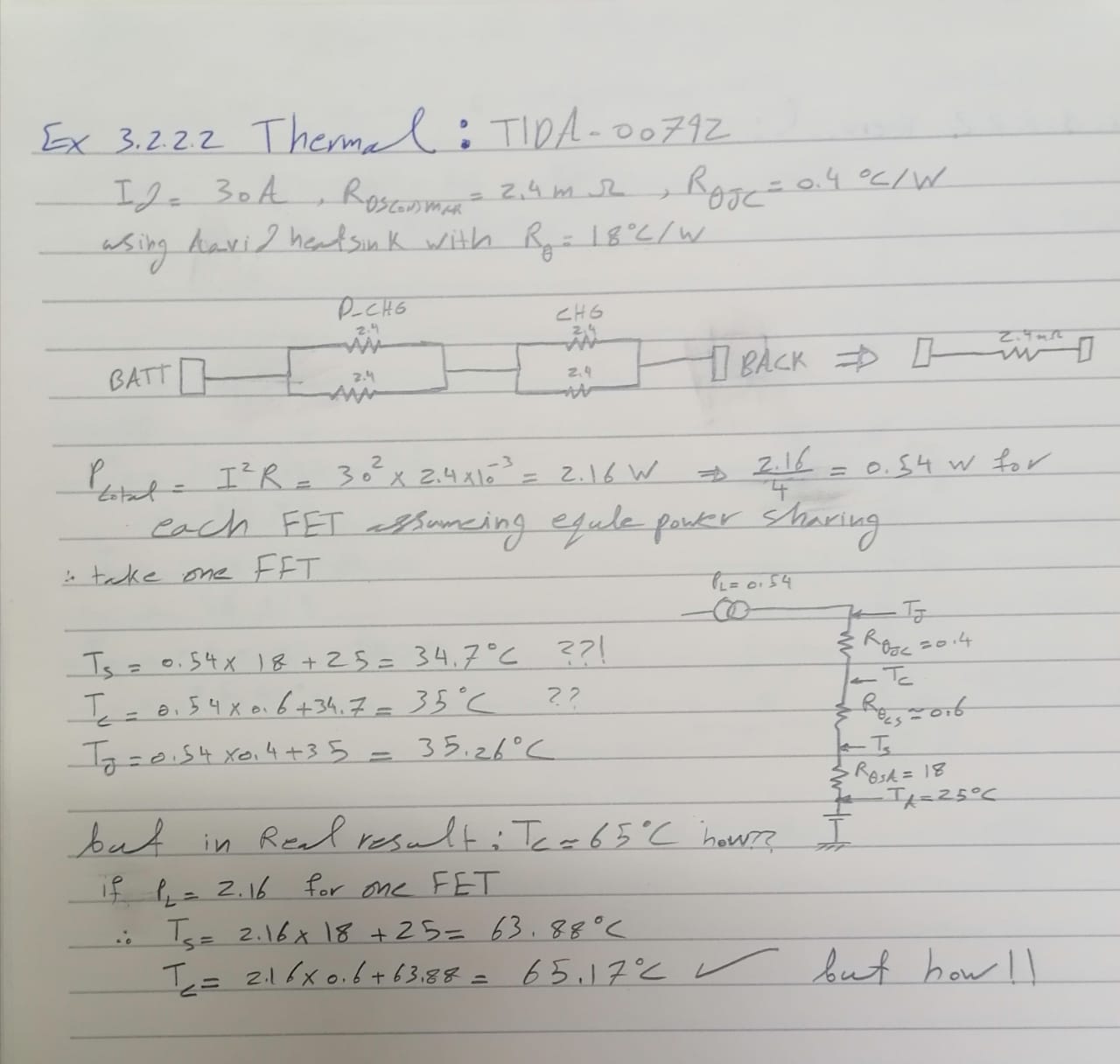

I just design a new BMS based on many reference designs with my own requirements, considering TIDA-00792 in "3.2.2.2 Thermal" when making the calculations based on total P_losses = 2.12W but with one FET everything goes right but as I think every MOSFET will share P = 0.54W (assuming equal power-sharing) so calculating based on P= 0.54W the result is far away from real value! why?
another question in my design the 4 FET share the same heat sink and total P_losses = 24W, it's correct to parallel the Junction-to-case thermal resistance, right?

  • Hi John
    Thank you for your help, so you say that it correct to calculate based on  P_losses = 0.54W for each FET, not 2.16W?
    But why when calculating based on P_losses=2.16W for each FET the results are found as in real test? it's a coincidence?
    And for your points: 1- I take the Max. Rds(on)=2.4
                                     2- No I don't have, but the heatsink is also rated at natural cooling (# 573300D00010G -> Thermal Resistance @ Natural:18.00°C/W).
                                     3- the RthetaCS value is very law mostly from 0.2 to 1.5 based on the interference compound.
                                     4- I don't think there is any heat source that makes this result very far.

  • Hi Rashad,
    I have to apologize. I sent this over to the team I thought had done this design to get their input and they have not responded. To address the power loss, my understanding is you either have the charge FETs on when charging the battery or the discharge FETs on when discharging the battery. Assuming the current divides equally between the two parallel FETs, the total conduction loss = I^2 x rds(on)/2 with each FET dissipating half of the total conduction loss. If your current is 30A, then the total conduction of two parallel FETs = (30A)(30A) x (2.4mOhm/2) x 1.3 (assuming 75C case temperature) = 1.404W and each FET dissipates about 0.7W.
    With regards to the thermals. The primary path for removing heat from the D2PAK is thru the tab. The thermal impedance TI specs in the datasheet is junction to bottom (tab). The thermal impedance thru the top of the plastic case is much higher. It is not specified in the datasheet but from thermal modeling, we estimate it is ~30C/W. Even if the heatsink makes direct contact with the plastic case, it's not a very low thermal impedance path. The heatsink looks like it solders down to the PCB. The primary thermal path will be from the tab, thru the PCB copper and into the heatsink. I'm thinking that is a lower thermal impedance than thru the top of the case to the heatsink. The total thermal impedance will be the parallel combination from junction-tab-PCB-heatsink-ambient and junction-top-heatsink-ambient. Please review and let me know if you have any additional questions.

  • Hi John,
    Thank you really for your help.

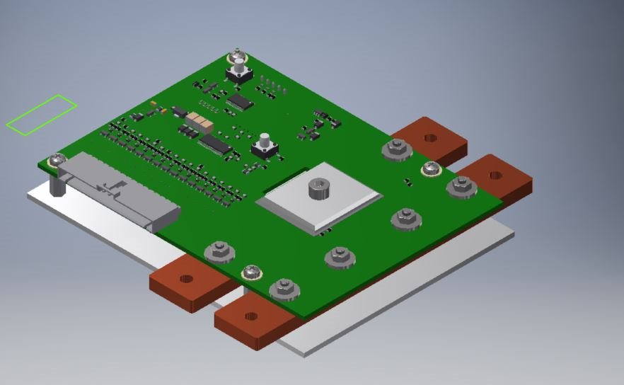

    I misunderstood that the thermal impedance TI specs in the datasheet is the junction to bottom (tab) and not junction to top, again thanks a lot! and because of this, I change the thermal design completely and I will upload photos for PCB design so you and everyone can give me any good advice to improve the design layout and I will be grateful to him also.

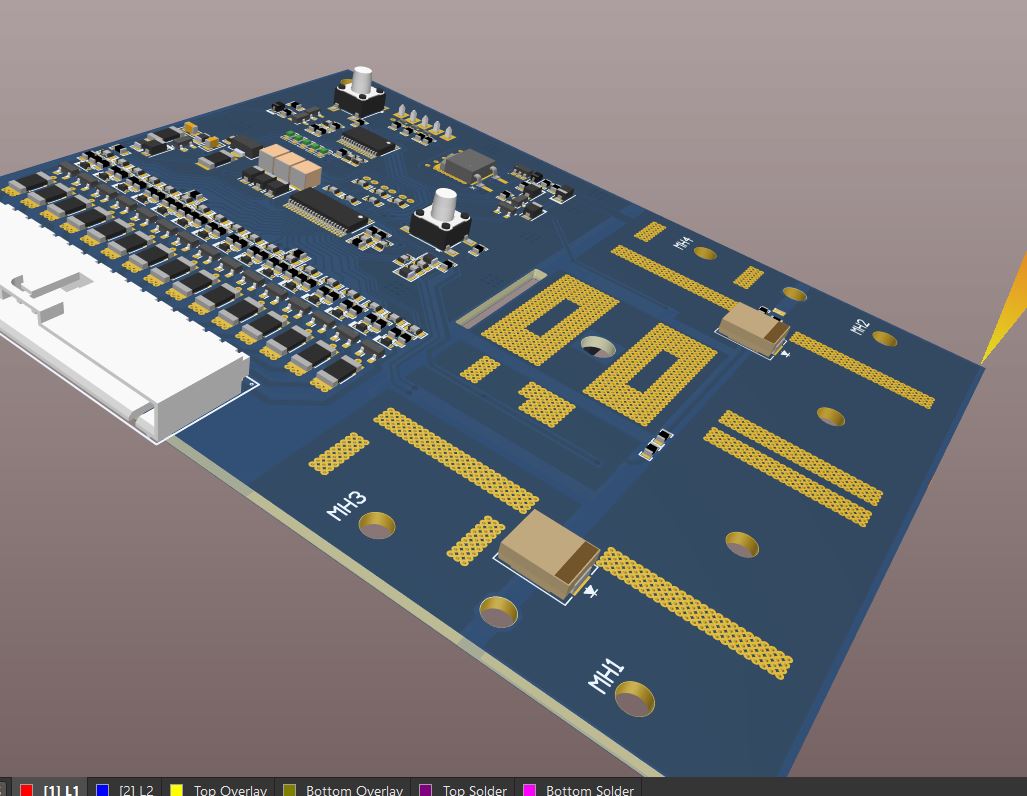

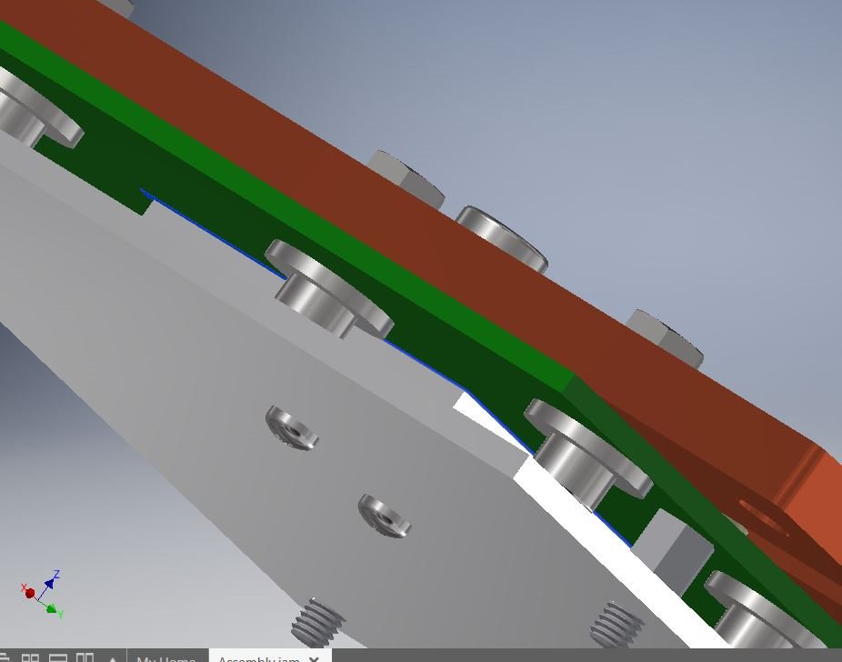

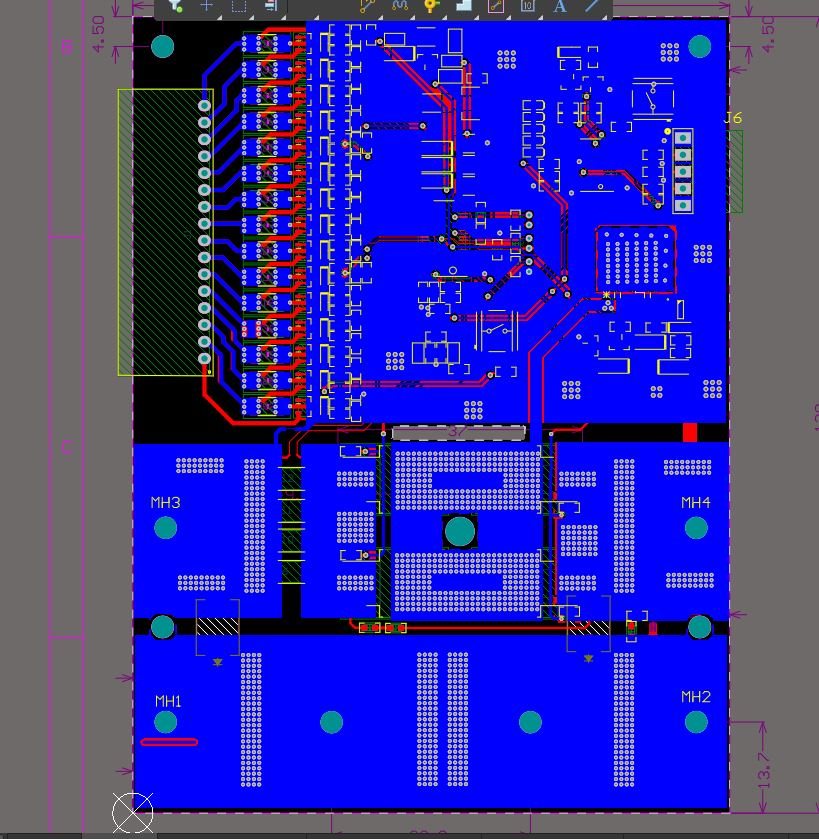

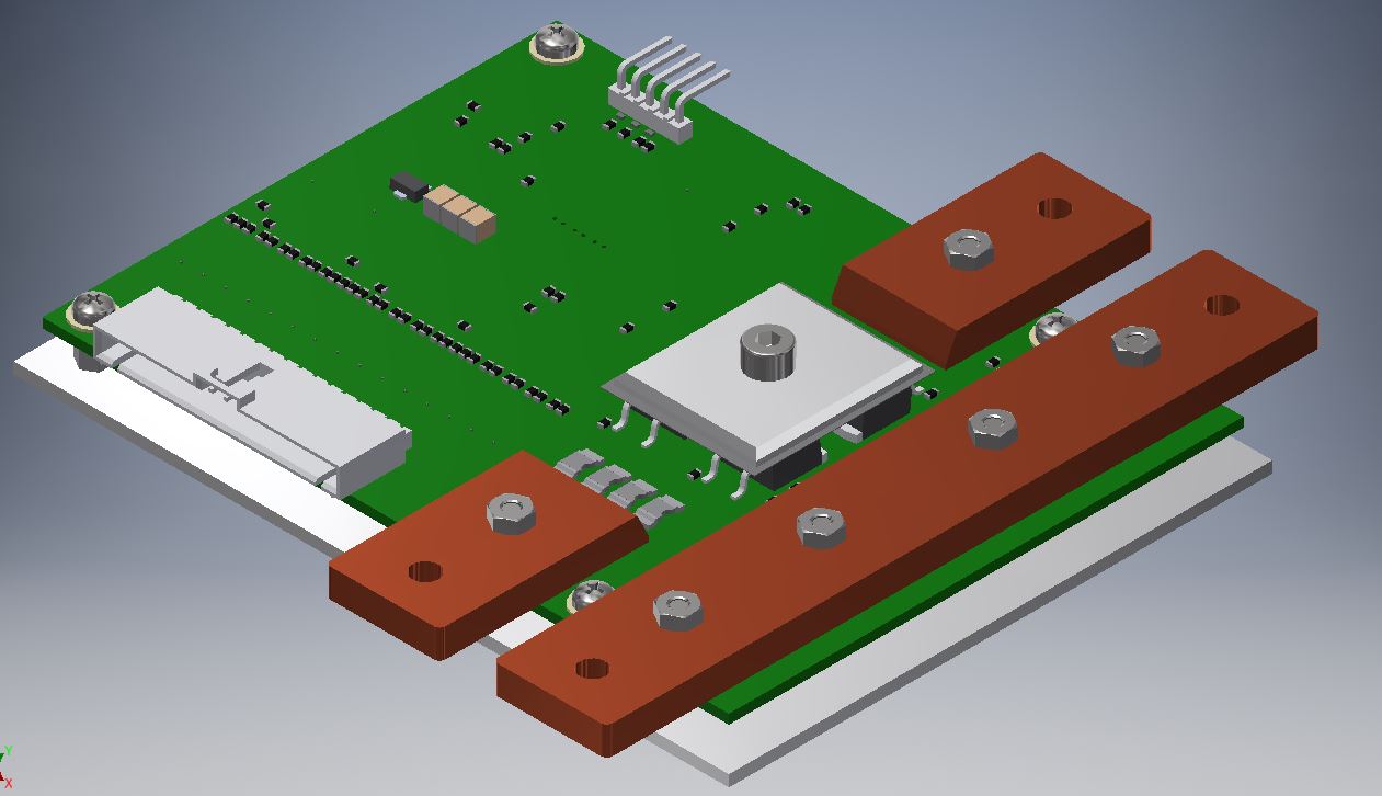

  • Hi Matt,
    Thank you so much:)

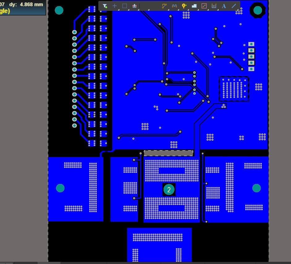

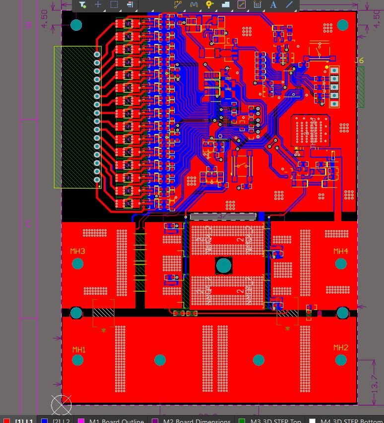

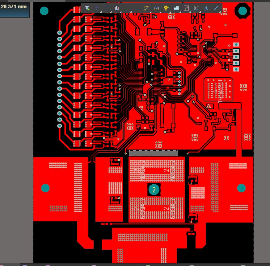

    I upload the third version of the design so maybe you can take a look, I just remove the long high current path from PCB to be cost reduction and more stable design, any comment is very welcomed.
    *100A continuous discharge current
    *200mA balancing current
    *0.5A Pre-charge current
    *Low-side protection switching with allowing communication while protected.
    If the schematic is needed I will send it to you.
    Thanks in advance.
    Rashad
  • Hi Rashad,
    The layout looks good to me. I'm not sure if John has additional comments on the FET portion, but it looks good to me.
    Matt
  • Hi Rashad,
    Thanks again for your interest in TI FETs. Based on what I'm seeing in the pictures the layout of the FETs looks good to me.
