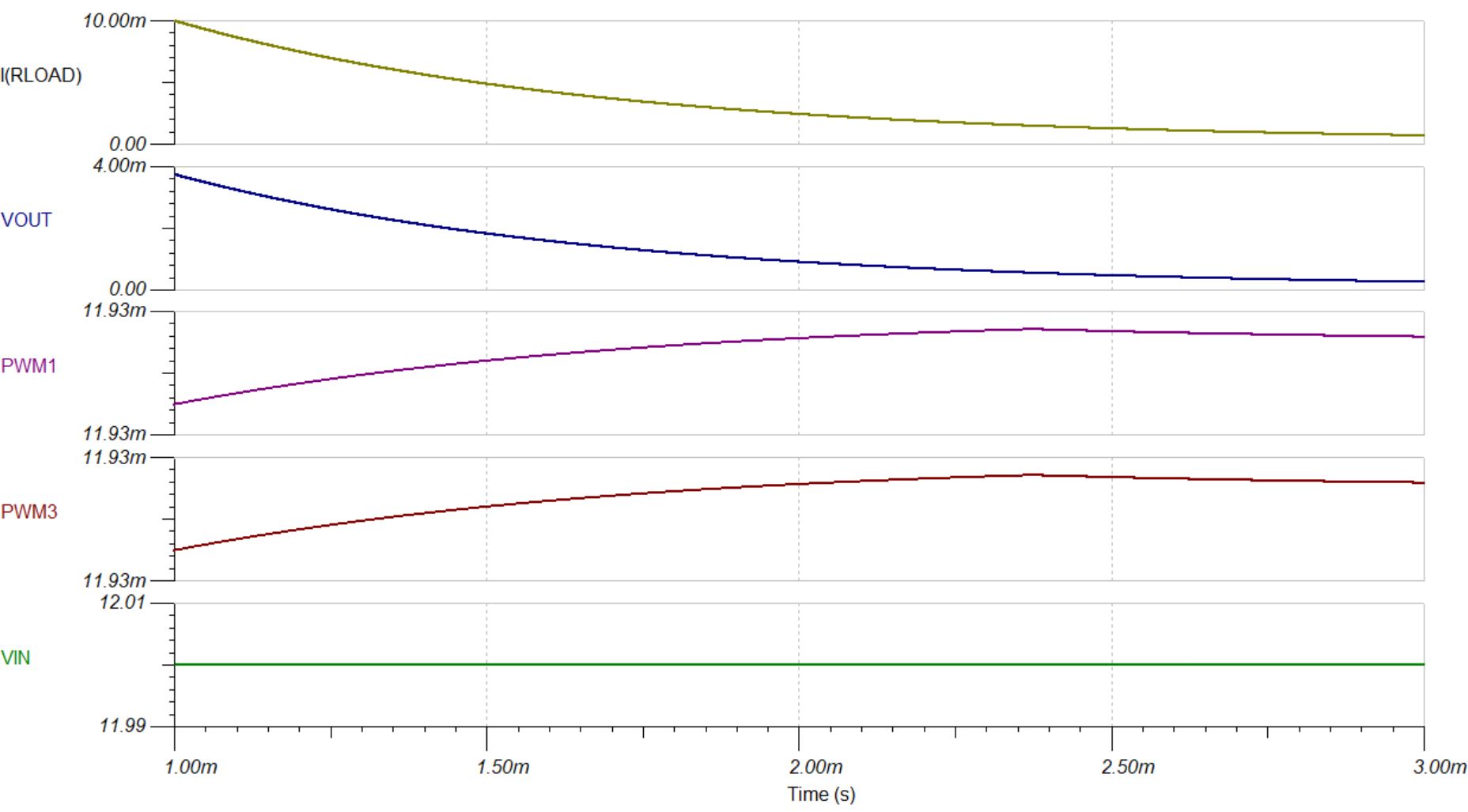

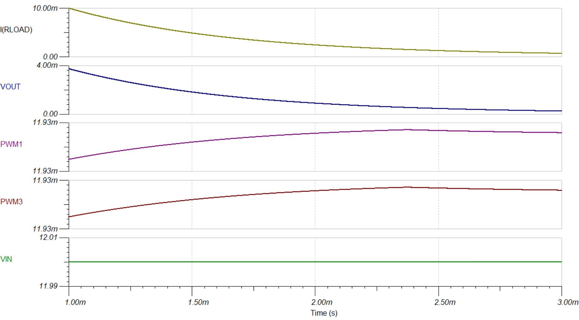

1. I'm configuring TPS40090 steady state reference design from 4 phase into 2 phase design. On top of this, i have already modify the design by using
external compensation circuit and external gate and mosfet circuit. This design has been set to 30V voltage output and 80A current output.
2. I have disabled PWM2 and PWM4 by connecting it to BP5 pin to convert it into two phase design as suggested by the design guide. CS2 and CS4 pin is also connected to CSCN. With this changes. I'm not able to get the desired output with the PWM1 and PWM3 going to max 12V as shown below.
3. But when i connect BP5 pin to a 5V voltage source. I'm able to get the programmed 30V80A output as shown below. May i know is it necessary to connect BP5 pin to a 5V source? Thanks in advance for your support. Attached are the simulation file for both working and not working setup.
TPS40090_extfeedbck_30V80A_extgdrivefet_working_two phase_working.TSC
TPS40090_extfeedbck_30V80A_extgdrivefet_working_two phase _not working.TSC
  • Hi Ammar,
    In TINA reference design on TI.com, the simulation is working fine without BP5 supplied by external voltage.
    In your TINA design, BP5 is supplying external circuit, I'm not sure if it causing the problem.
    Can you disconnect BP5 from LM324, use a separate power supply for LM324 and try again?
    Qian
