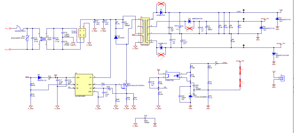

I am working on TIDA-010071 for relay switching, But I`m not getting output power from the power supply section. I`m providing 230V AC i/p supply  to the circuit.

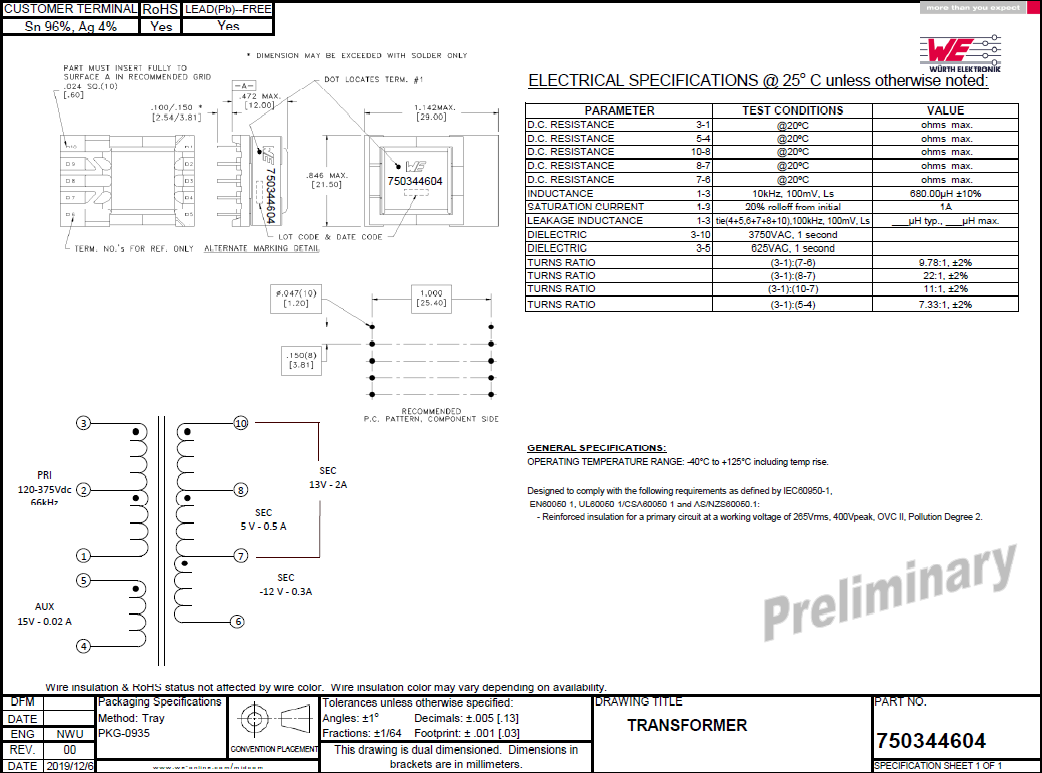

I have used transformer 750344604(datasheet attached) to meet my required power ratings{(13V,1.2A)(5V,0.5A)(-12V,0.3A)}. Firstly, I have not made any change in the power section rather than changing the transformer, but i didn`t get output power, then I have made some changes, like I have change the value of Rs1- 59k to 120k, Rs2- 20k to 56k and Rlc- 1.10k to 4.7k for Vs and Cs pins of UCC28740DR.
The only fluctuating 6V to 17V voltages i`m getting on VDD pin of UCC28740DR.
Please help out to get the output power
