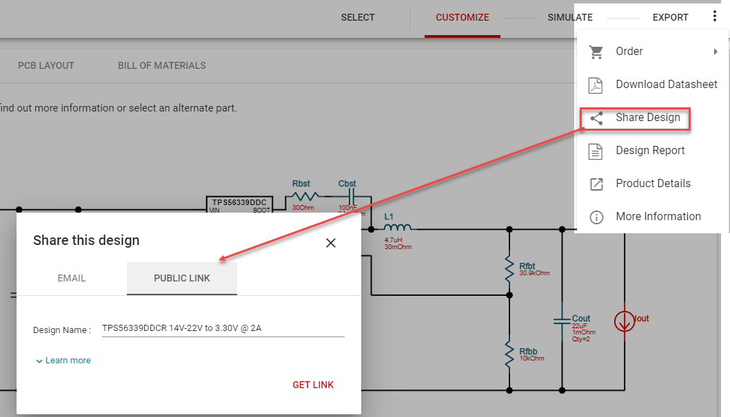

  • Graciano,
    Thanks for your question. Would it be possible to share the input conditions (VinMin, VinMax, Vout, Iout, Ta) you are running the TPS61022 at? Ideally, if you can share the WEBENCH design, that would be good - please see screenshot below for reference. TPS61022 is rated for 8A valley current limit so depending on your input conditions, we may need to check if we hit that limit or not.

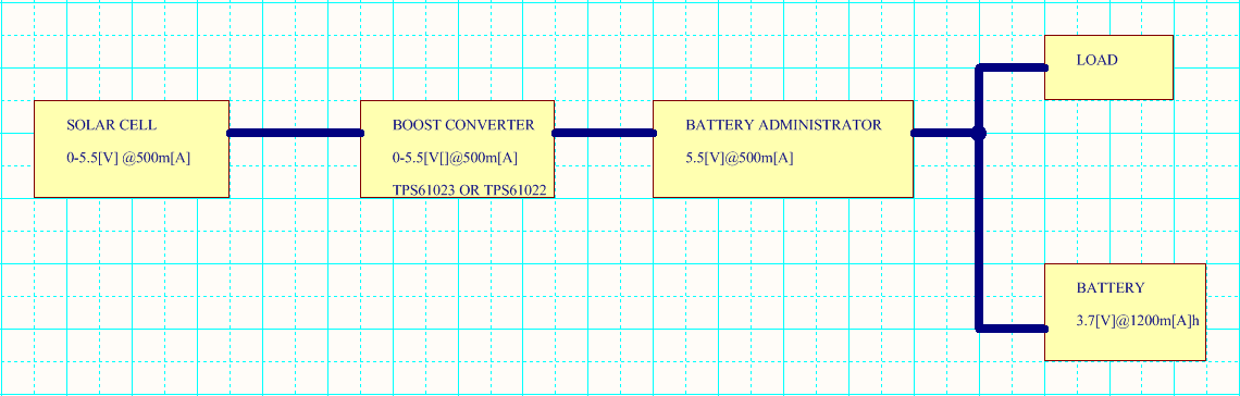

  • Dear Zack Liu.
    I hope you have a nice day.
    This is the block diagram about I want to do.
    The solar cell can be 8[V]@450m[A], I can control the input voltage maximum; I want to know if the boost converter is ritgh to this configuration and if this can manager the input current.
    The input voltage is variable but i would like to control it with the boost converter then I want to know wich one can I use it, wich is the better choice.
    thanks a lot.

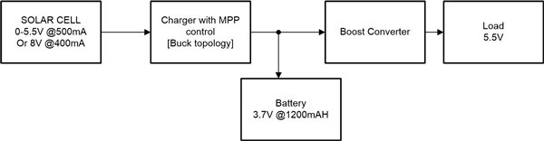

  • Hi Graciano,
    Since the input is a 5.5V or 8V solar cell which is higher than the battery voltage range, and you have to implement the Maximum Power Point Tracking (MPPT) control, I think a buck topology solar cell charger IC is more suitable. I draw a simple block diagram shown as below. The charger IC will charge the battery. Another boost converter is needed to boost the battery's voltage to the load needed voltage level. Let me know if you any questions.
