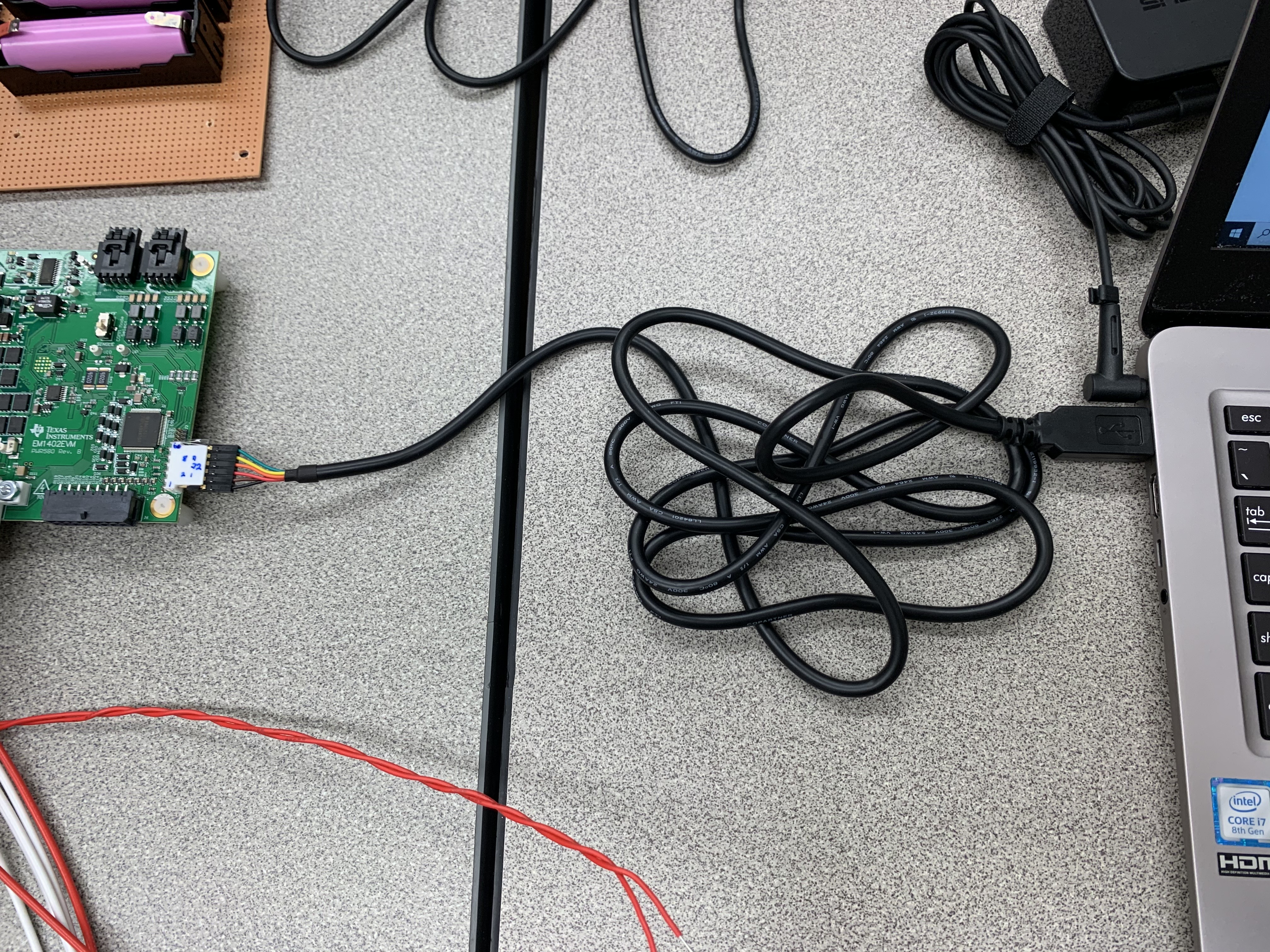

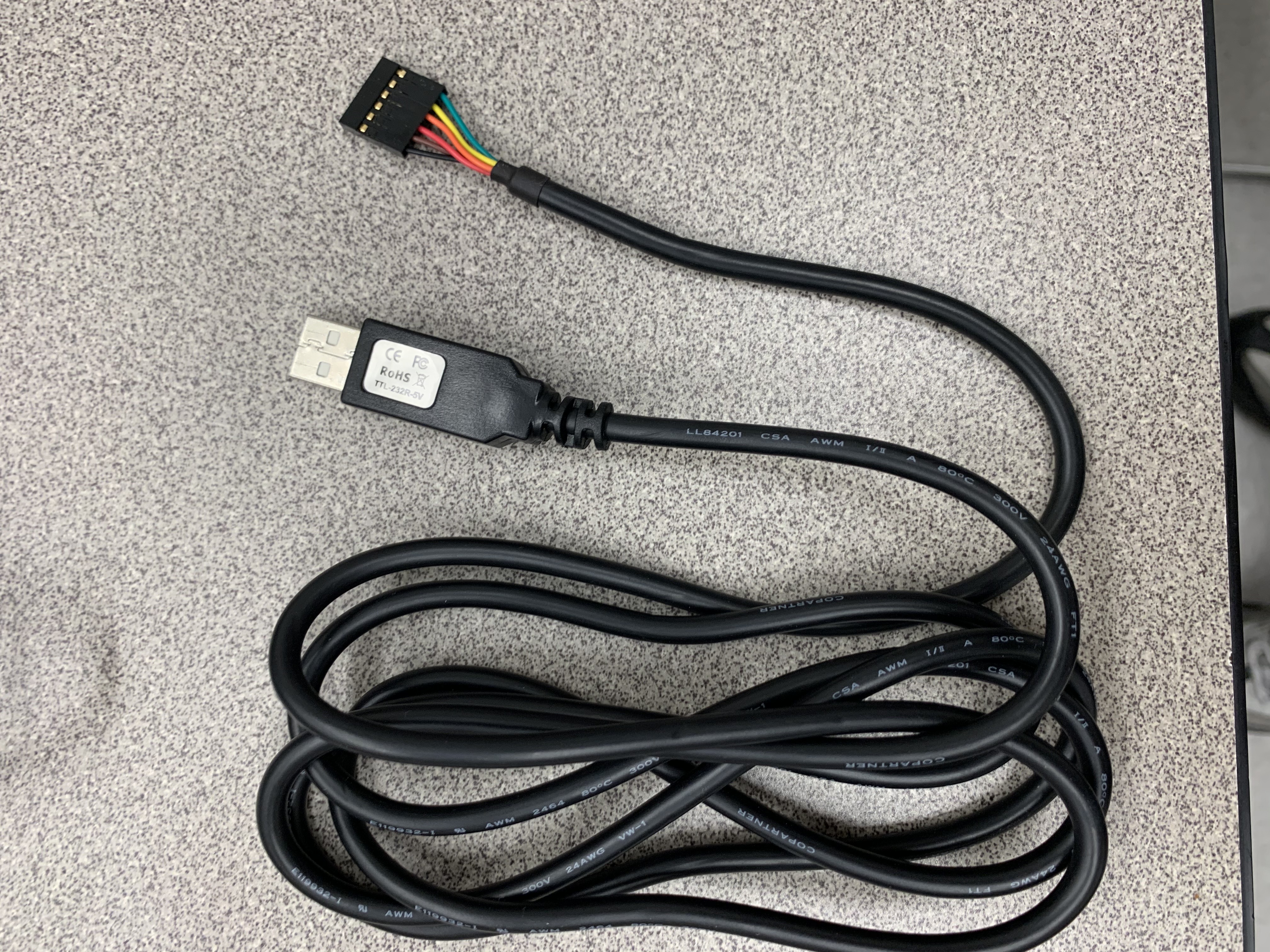

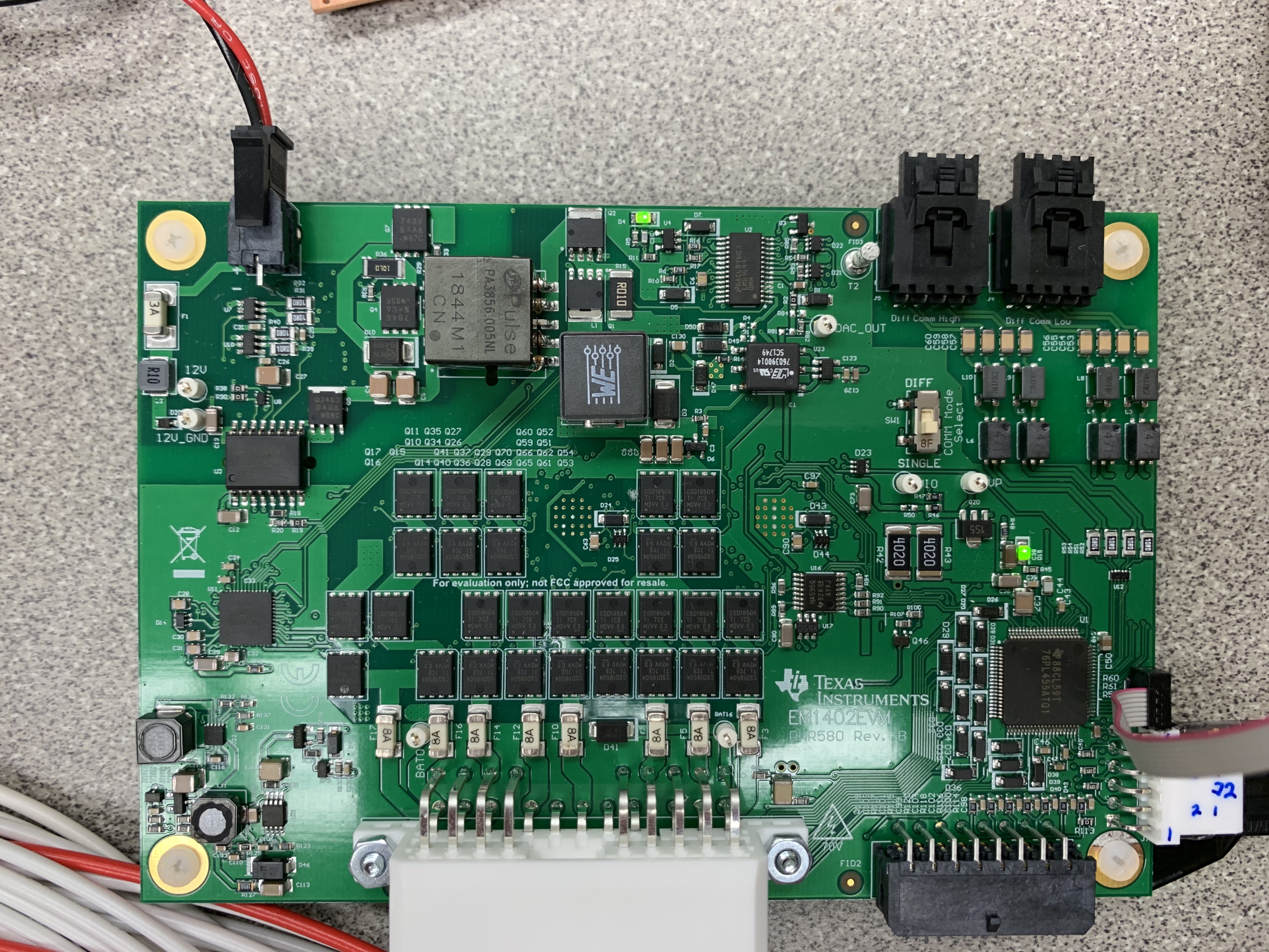

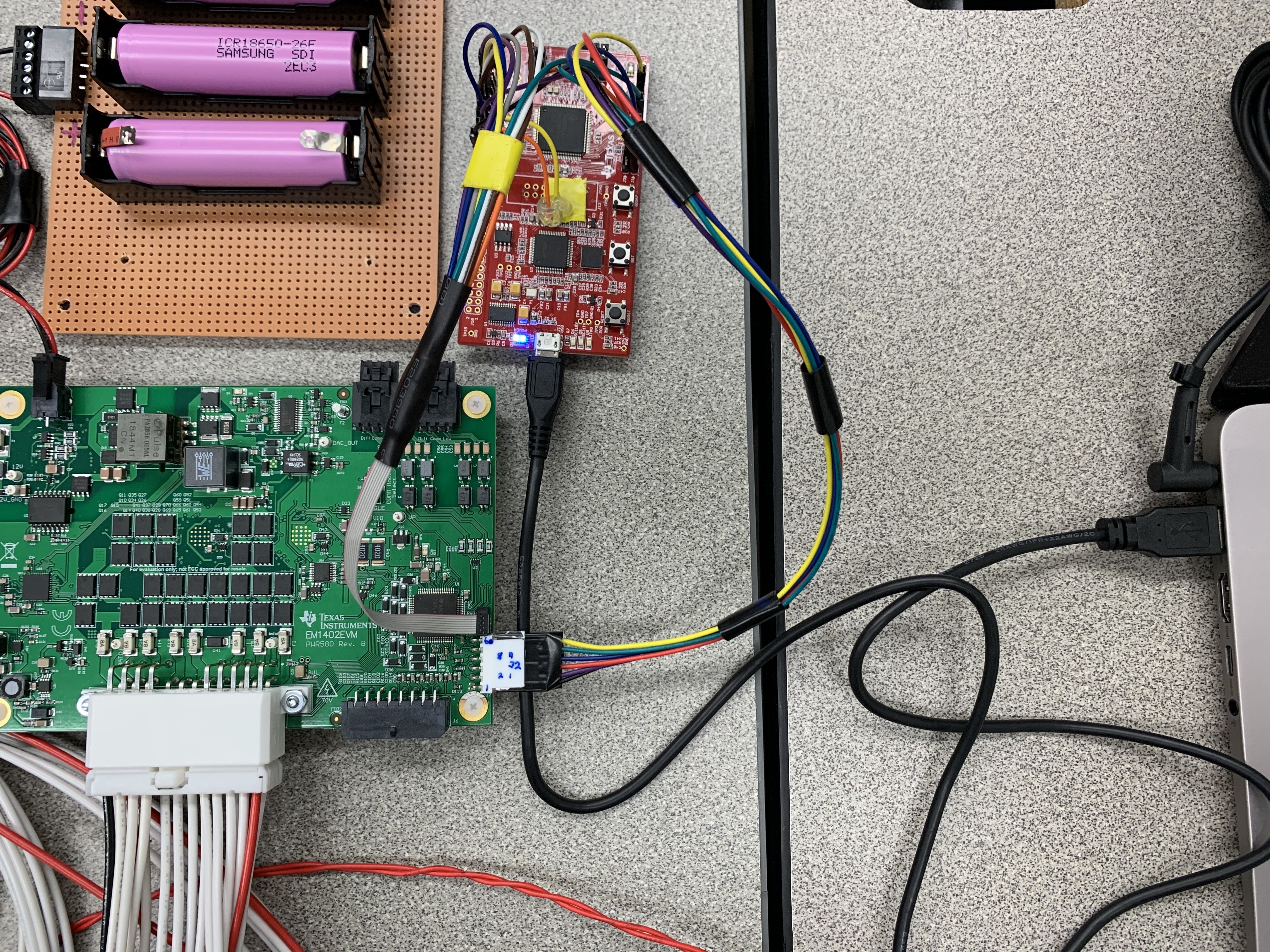

    Can you please clarify what you mean by this: "I checked with the usb to TTL serial cable delivered with EVM board to connect direct from BMS board to host pc. It can allow me to enter gui." ?
    Can you please send a picture of your setup (including cable used to communicate to PC) when using the USB to TTL cable you mentioned  and another picutre when using the setup that is not working? I want to understand what is the difference between these.
    Leslie
  • Thank you for your reply.
    It means I used the cable delivered with EM1402EVM to connect between EM1402EVM and Host pc
    This is the cable image
    This is the connection between EM1402EVM board and Host PC
    Then I can enter the bq gui. with the proper message
    This is the picture of using mcu and EM142evm Board
    Then I can mee the error message with "unable to open com port" message.
    Thank you.
    Could you ensure all of the steps in parts 4 and 5 of this document have been followed perfectly:
    http://www.ti.com/lit/ug/tidubi0/tidubi0.pdf
    There have been several similar issues mentioned with the COM port, and those two sections consistently assist in debugging the issues.
    Additionally, please monitor the lines with a logic analyzer, as it is possible that because you are connecting a 5V logic line (FTDI cable) to the microcontroller 3.3V logic line, you may have issues. Lastly, with these logic analyzer scope plots, ensure that the data you are expecting is arriving at the correct locations.
    Let me know if you see any strange behavior with the logic analyzer, as I think that will provide the best debugging assistance!
    Vince

  • Ok.
    I finally can open the COM port.
    https://e2e.ti.com/support/microcontrollers/hercules/f/312/t/689252
    This thread helped me.
    Problem is The example code in
    http://www.ti.com/tool/EM1402EVM
    is what I have used until today. But with this code definitely not work.
    But the code I can get it from this page :
    http://www.ti.com/tool/TIDM-TMS570BMS#technicaldocuments
    The File Link :
    www.ti.com/.../tidcbz0
    After I import this project with CCS 6.2, I can open the COM port.
    whether the balancing is work or not, I can run the GUI with this.
    I hope it will help someone who has the same issue.
