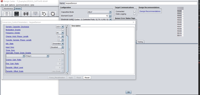

          Its difficult to set,read,apply the parameters. when more than 5 self cap buttons are used. i have attached screen shot for reference. Please do improve the GUI for next updates.

    No I am not referring to this. I mean the Apply, Force Recalibration, Read, Reset buttons are disappeared, as you can see from the screen shot. These buttons are required when re-calibrating to the custom board. And also when setting the element count to >= 5 in Self Capacitive Mode, it does'nt  show up in the GUI. For this Problem solution is setting the element count to 10 in  Mutual capacitive mode , then changing the mode to Self Capacitive mode.

  • Hi Gourav,
    Our GUI engineer has the following feedback:
    This can happen if the customer has resized the customizer window and reduced the height.  On second reading of the issue, I see that setting the button group to something that produces a long “column” of buttons this can happen too. The fix is the same, resize the customizer window height.
    I tried to create 12 button, as you did, and yes, the customizer window didn't fully open.  If you grab bottom or corner with mouse, you should be able to expand the window.  Try it and let me know.

              My laptop screen size is 14.1 inch, that is the max I can stretch/Extend the the customizer window. If you could change display of long column of buttons (vertical) to long row of buttons(horizontal), this might solve the issue.

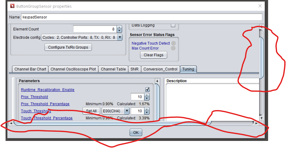

    Our GUI engineer is suggesting that you can "undock" the sensor tuning or conversion control tab from the sensor properties view by clicking on and dragging away the wide bar to the left of the parameters.  Here is a picture.  The undocked view should provide you enough room to expand it to see the missing buttons.
    Regarding the issue with not being able to create more than 5 self cap sensors, both he and I were not able to recreate the issue.
    His suggestion is to create the 10 mutual sensors but don't switch them to self cap, save the project (.ser file) and attach to your reply posting.

  • Hi Gourav,
    The design center has been updated to include sliders as shown here.  Next release end of April.
