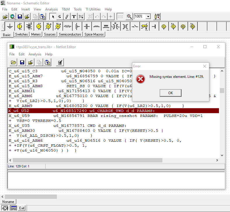

I'd downloaded TPS3851 Unencrypted PSpice Transient Model from the TI website and tried to add to Tina. It shows below error.
How do I resolve this?

I will need time to investigate this issue. Have you tried to use the file to another program such as PSpice? This will help narrow the issue root cause down to the file or the simulator program. Thanks

The syntax is the same syntax I am seeing. After investigating, I believe the issue is because of the version you are using of TINA 9 makes some models incompatible because of syntax. Please update TINA to the latest version (v9.3.200.277 SF-TI ) and let me know if this resolves the issue. Thanks
