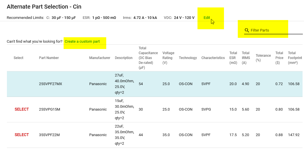

    The WEBENCH design doesn't allow you to add an additional cap in the schematic, However, you can calculate the total capacitance in parallel and select the alternate cap using' Choose Alternate component'. Please find the steps below.

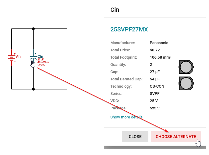

    1. Click on the component which you want to change and click on '' Choose Alternate component'.

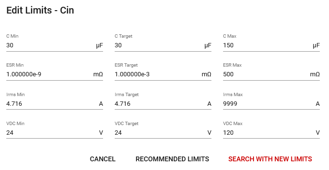

    2. Click on 'Edit' to filter out components.
    3. Change the component limits as per your requirements.

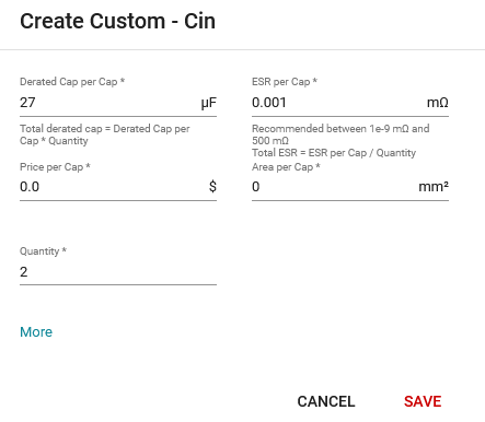

    4. Alternatively, you can create custom components.
    Please let us know if you are facing any issues.
