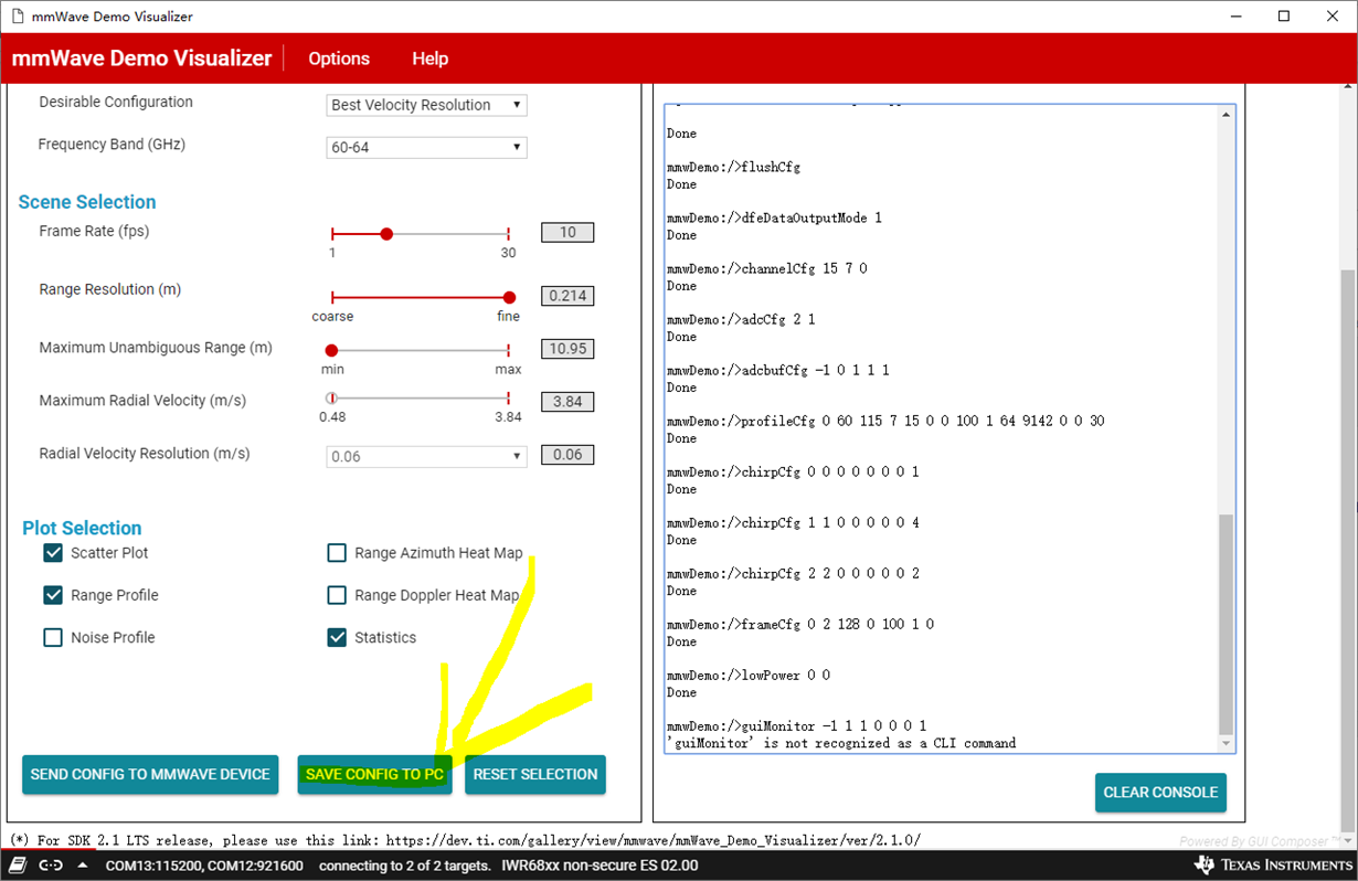

Hi:
       I want to confirm whether this tool can help me customize the corresponding configuration (such as the farthest detection distance, distance resolution Deng), and then visualize the point cloud map to observe the effect of the modified configuration. Finally, I save the corresponding configuration file and put it into my corresponding application for use.
And I met this problem when using the visualizer, as shown in the lower right corner of the figure above: 'guimonitor' is not recognized as a cli command
My configuration is as follows (local rather than online):
  1. IWR6843ISK-ODS
  2. sdk:wave_ sdk_ 03_ 03_ 00_ 03
  3. bin:mmwave_ industrial_ toolbox_ 4_ 3_ 1\labs\people_ counting\68xx_ 3D_ people_ counting\prebuilt_ binaries\3D_ people_ count_ 68xx_ demo.bin
  4. runtime:gcruntime-7.2.0-windows- installer.exe
  5. viualizer:mmWave_ Demo_ Visualizer-3.4.0.setup-win_ 7.4.1.exe
First of all, I want to make sure my toolbox is still 4_ 3_ 1 (official website is up to date). On this basis, how should I choose other versions.   And I wonder if the bin(3D_ people_ count_ 68xx_ demo.bin) in the board not accept the "guimonitor" parameter. What shall I do?
 thank you.
