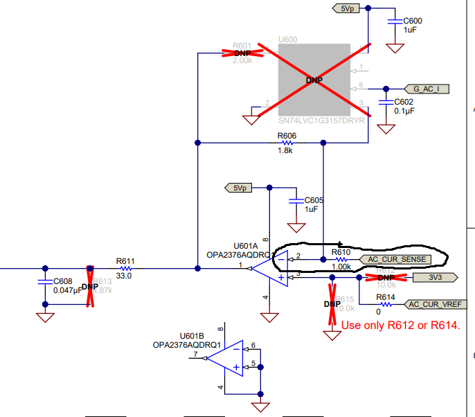

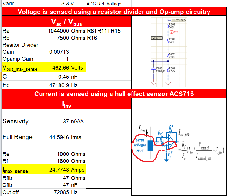

If you look at <Main.cfg> of CCS, there is a circuit diagram at the top.
If you look at this picture, Rfltr, Cfltr appear in 2 parts in total.
It looks like the picture below.
However, which part of the 1 or 2 displayed above is the value written in the Sesne Filter item of <Main.cfg>?
