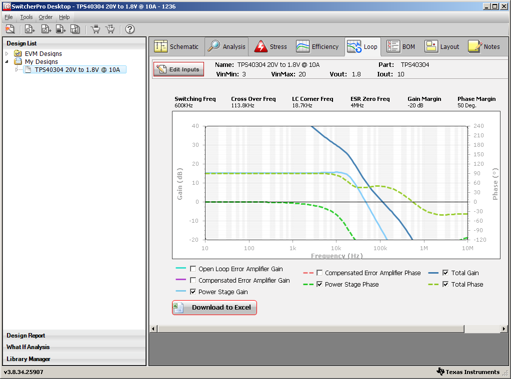

Hi Nikhil,
I want to do small signal ac analysis. The transient conditions aren't required for this type of analysis.
Ron
Hi Ron,
If you are just looking to do an ac analysis, then Switcherpro will give you the same loop stability information that you will get from a state space average model. Please find some snapshots below which shows the loop response. You can also change the compensation components to see how the loop response changes in the What if Analysis Tab.
